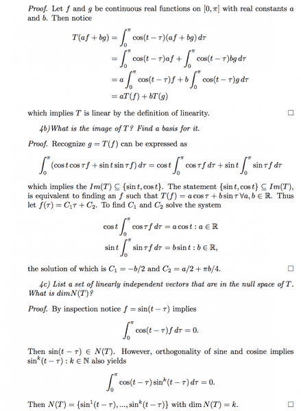

How does this look?

You need to rethink the kernel.
I sense some confusion. The input of [itex]T[/itex] is a function of one real variable, which we are labelling [itex]\tau[/itex]. The output of [itex]T[/itex] is another function of one real variable, which we are labelling [itex]t[/itex]. Setting [itex]f(\tau) = \sin(t - \tau)[/itex] therefore is nonsense; trying [itex]f(\tau) = \sin (\alpha - \tau)[/itex] for real [itex]\alpha[/itex] makes sense, but it turns out that that is not in the kernel for any [itex]\alpha[/itex].
Finding functions in the kernel is actually straightforward: You can readily show that if [itex]h(\tau) = a \cos \tau + b \sin \tau[/itex] then [itex]T(h) = \frac{\pi}{2}h[/itex], and having established that the image of [itex]T[/itex] is the space spanned by [itex]\cos[/itex] and [itex]\sin[/itex] it then follows that [tex] T^2(f) = \tfrac{\pi}2T(f)[/tex] for all [itex]f \in C[/itex], and hence by linearity of [itex]T[/itex] that [tex] T(f) - \tfrac{\pi}{2}f \in \ker T[/tex] for every [itex]f \in C[/itex]. This gives you a way to easily find non-trivial members of the kernel, provided you are careful with your choice of [itex]f[/itex].
