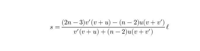

My total distance is this equation

Do you want us to check it for you? We do that, on occaision, depending on what else is goin' on in our lives. You did not respond to my two questions. Please do.

Yep, please check it for me. I think it's a difficult one and want to share for everyone. Just that :)
That doesn't look right to me at all. I would expect to see n as an exponent in the answer.
It is certainly wrong at n=2, but that can be corrected merely by changing one sign in your answer.
Edit: all nonsense... see post #9.
Please post your working.
Yes, with n=2 it's quite simple and the original of this exercise. I'm trying to do with n>2. Okie

HP-Physics said:
I'm really sorry about my English grammar, it is not good
I take it all back. 🤭
My intuition about the form of the answer was based on a wrong view of the question, and I blundered in checking your answer at n=2.
I get the same answer as you do, by a somewhat different route.
How do you think, about this problem?
