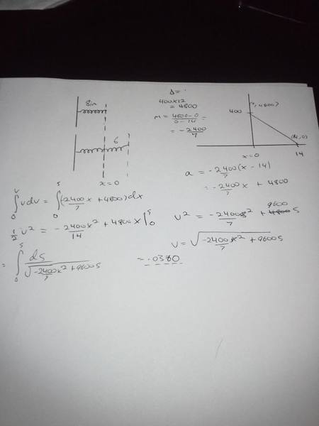

the 14 in. spring is compressed to an 8 in length, where it is released from rest and accelerates black A. the acceleration has an initial value of 400ft/sec^2 and then decreases linearly with the x-movement of the black, reaching zero when the spring regains its original 14 in. length. calculate the time for the black to go to 3 in.
just wondering If I am on the right track. I believe that is the right function for acceleration of a displacement. I am unsure about initial velocity though. Yes I made the adjustment to a=-240x+3360
[URL=http://s1341.photobucket.com/user/nebula-314/media/20131225_150014_zpsac8609aa.jpg.html][PLAIN]http://i1341.photobucket.com/albums/o745/nebula-314/20131225_150014_zpsac8609aa.jpg[/URL][/PLAIN]
How do you get x = -6in. for the compressed length?

yea idk I took x to be in the positive direction to the right, thus giving me a negative X.
I want to use the equation of acceleration as a function of position a=f(s). and.
[itex]\int^{V}_{V0}[/itex]vdv=[itex]\int^{S}_{s0}[/itex]f(s)ds
to derive me velocity as function of position then, use that to further drive the equations for time.
I am just having trouble with the initial acceleration function.

The spring has a relaxed length of 14 in. When it is compressed to being only 8 in. long, how much has it been compressed by?
Your diagrams on the RHS of the OP are correct, but the graph on the left is wrong. I think you have been inconsistent in what you mean by 'x'. In the lower diagram you have x as the change in length, which starts at 0 and becomes -6. But in the graph you have x changing from 14 to -6.

Ok my new strat, a= [itex]\frac{-2400x}{7}[/itex]+4800
(general integration setup
[itex]\int^{V}_{0}[/itex]vdv=[itex]\int^{X}_{0}[/itex] ([itex]\frac{-2400x}{7}[/itex]+4800)dx
gives me V= [itex]\sqrt{\frac{-2400x^2}{7}+9600x }[/itex]
then, velocity as a function of position.
[itex]\int^{t}_{0}[/itex]dt=[itex]\int^{3}_{0}[/itex][itex]\frac{dx}{ \sqrt{\frac{-2400x^2}{7}+9600x }}[/itex]
put that into wolfram
gives me .0360 sec, book says .0370 sec
This time I used the position of 8 in as x=0, which allows me to generally set up an integration for velocity where initial position is zero. does this look correct?
got it guys finally!, Yes you were right haruspex I was having HUGE difficulty as to what was being meant by "X". Thanks for the help haruspex.
[URL=http://s1341.photobucket.com/user/nebula-314/media/20131226_161422_zps90413be0.jpg.html][PLAIN]http://i1341.photobucket.com/albums/o745/nebula-314/20131226_161422_zps90413be0.jpg[/URL][/PLAIN]
I confirm the answer. My method is rather different.
