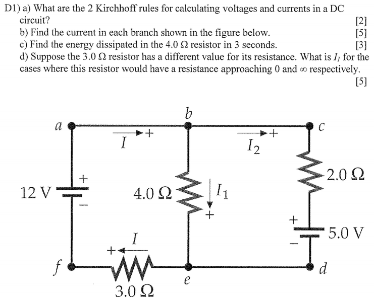

[tex]\sum I_{in} = \sum I_{out}[/tex]
[tex]\sum \epsilon = \sum pd[/tex]
Can anyone identify any mistakes in these? Probably signs
[tex]I = I_1 + I_2[/tex]
[tex]12=4I_1 +3I[/tex]
[tex]5=4I_1 - 2I_2[/tex]
[tex]12-5=2I_2+3I[/tex]
BvU said:
What let's you think there are any mistakes ?
The answers have I1 and I2 with opposite signs. I get them both as positive.
I make all currents positive for the directions shown.
I'm not sure what is achieved by that + sign accompanying each current arrow? It seems superfluous if it duplicates the function of the arrowhead, and just clutters the diagram.
Well that's good news. And, yeah, I guess it's just intended to help with the maths side of things.
