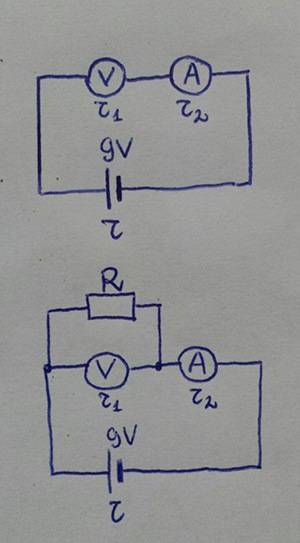

A circuit contains 9V battery ,which internal resistance is unknown, an ammeter and a voltmeter, whose resistances are also unknown. When a resistor was connected to the voltmeter in parallel, the voltmeter's value was reduced 2 times and the ammeter's value doubled. What did the voltmeter show before the resistor was connected?
Kirchhoff's Rules
Here's my drawing:
I know that:
##I_2=2I_1##
##V_1=2V_2##
From first drawing I get:
##V_1=I(r_1+r)##
##I_1=I-9/r##
If I could express the same values (V1 and I1) maybe I could equate them and get the answer, but I am not sure how to do this.
Hello Kaspis,
You confuse yourself by using i, i1 and i2 in both pictures. They are not the same !
Also, you want to introduce the resistances of the meters Rvm and Ram (which are the same in both pictures).
Draw the voltmeter with it's internal resistance shown and the same thing with the ammeter, then analyze the circuit. Don't just write thinks down without drawing the whole circuit you are trying to analyze.

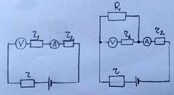

I've redrawn the circuit with internal resistances shown:
(1) why do you show two resistors associated with the voltmeter?
(2) where is the analysis that you are supposed to do based on the diagram (once you are sure what diagram you are using) ?
r1 is voltmeter's internal resistance and R is the resistance of the newly connected resistor. Are these circuits drawn correctly?

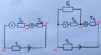

I'm a bit new to this, but here's what I did:
From the left circuit:
## \frac{V_1}{r}-\frac{V_2-V_1}{r_1}-\frac{V_3-V_2}{r_2}=0##
From the right circuit:
## \frac{V_1}{r}-\frac{V_2-V_1}{\frac{Rr_1}{R+r_1}}-\frac{V_3-V_2}{r_2}=0##
Is it correct?
What about the 9V from the battery ? (construct the simplest possible case if in doubt -- just an ideal battery and 1 resistor).

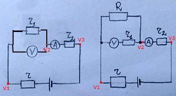

No. It is wrong.
An ideal voltmeter has infinite internal resistance. The internal resistance of the real voltmeter is supposed to be connected parallel with an ideal voltmeter.
In your circuit on the left, no current flows.
Also notice, that everything is connected in series in the left circuit. The currents through r1 and r2 do not add up.

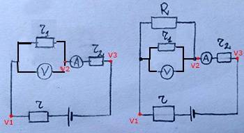

So my drawing of the left circuit is incorrect, but I don't think this affects the equations. Even if I connect voltmeter's internal resistance parallel to the voltmeter, total resistance of that part of the circuit remains the same ##r_1##.
The total resistance of which part of the circuit?
The total resistance between V1 and V2 would remain the same regardless if I connect V and r1 parallely:
If you connect an ideal voltmeter parallel with resistance r1, The resistance between V1 and V2 is r1. If you connect r1 in series with the voltmeter, the total resistance is infinite. The circuit on the right is still wrong.
What do you know about the currents flowing through each resistor?
