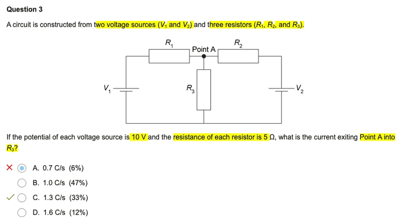

If the potential from each voltage source is 10V and the resistance of each resistor is 5Ohms, what is the current exiting point A into R3?
Loop rule: \oint {\vec{E}} \cdot \left{\vec{dl}} = 0
Junction rule: \sum{I_{in}} = \sum{I_{out}}
Consider the problem below
I used Kirchoff's loop/junction rules to correctly arrive at answer C (1.3A). Before using Kirchoff's rules I tried to get ##V_3## by treating this as a Fermi problem using the following lines of logic, but there is a flaw somewhere, can someone identify the flaw?
(a) If ##V_1 = V_2##, we can assume no current from either power source branches at junction A and everything exits through ##R_3##.
(b) If there is no current branching, we can treat each loop independently as a series circuit.
(c) If I can treat each loop independently as a series circuit,
$$I_I = \frac{V_1=10}{(R_1=5) + (R_3=5)}$$
$$I_2 = \frac{V_2=10}{(R_2=5) + (R_3=5)}$$
(d) ##I_3 = I_1 + I_2##
(e) ##I_3 = 2##
(c) & (d) & (e) follows from (b), implying each loop cannot be treated independently. But why must this circuit be treated as parallel if there is no current branching?
The question asks for the current, not the voltage.
If the two voltage sources are identical, and share the same common node, then they can be joined in parallel, and one eliminated.
Then R1 and R2 are in parallel, and in series with R3.
The resistance of the circuit is then known, (5/2 + 5) and so is the current.
No, because the conductive capacity of ##R_3## is shared in some way between those two loops. Given the symmetry, it is shared equally, so in each loop it provides resistance ##2R_3##.
Why is branching the criterion you're using? The currents "join" at point A. Isn't that just branching in reverse?

haruspex said:
Coulombs/sec?
Coulombs/sec = amp.
That seems likely, but the answer is still a little bit wrong.
R = 5/2 + 5 = 15/2 ohms.
I = 10 * 2/15 = 20/15 = 4/3 amp ≠ 1.3 amp
