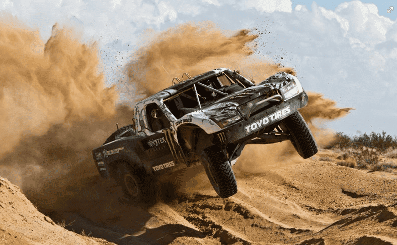

Vehicle that can maybe handle it?
These might come close:
In this video there are some brutal landings to flat where even 3ft of suspension travel does naught:
Likes Whitestar
Yes, I'd figured it would be something like those vehicles.
