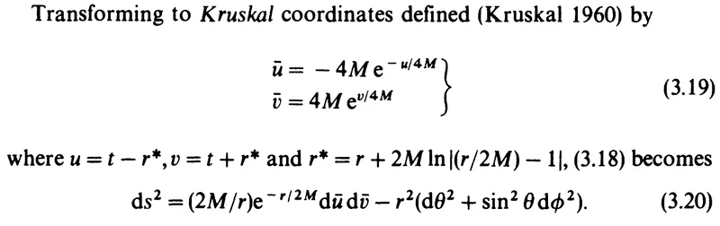

I am reading the book by Birrell and Davies on QFT on curved spacetime.
On page 40 they write the following metric:
Equation (3.18): ds^2 = (1 - 2M/r)dt^2 - (1 - 2M/r)^-1 dr^2 - r^2(dtheta^2 + sin^2 theta dphi^2), the Schwarzschild line element.
and on the following page they provide the Kruskal Coordiantes and the changed metric:
Text showing Kruskal coordinates: ū = -4M e^(-u/4M) and v̄ = 4M e^(v/4M), with u = t - r*, v = t + r* and r* = r + 2M ln|(r/2M) - 1|, followed by the metric ds² = (2M/r)e^(-r/2M) dū dv̄ - r²(dθ² + sin²θ dφ²).
Now, I get something a little bit different than theirs.
According to my computations, if we change ##2M/r## to ##(1-2M/r)## and ##e^{-r/2M}## to ##e^{-r^*/2m}##, then I get that by Kruskal transformation that (3.20) is equivalent to (3.18).
Am I right?
If you'll post your calculations, we'll be able to comment (and if you do so, please use LaTeX (which enables quoting)).
OK, here are my calculations. Let me know where did I get it wrong.
So we have the following: ##d\bar{u}=e^{-u/4M}du## and ##d\bar{v}=e^{v/4M}dv##.
Now, we should multiply ##d\bar{u}d\bar{v}=e^{(v-u)/4M}dudv##.
Now, ##du=dt-dr^* , dv=dt+dr^*##, so multiply and get:
##d\bar{u}d\bar{v}=e^{(v-u)/4M}(dt^2-(dr^*)^2)##, notice that: ##v-u=2r^*##, and ##dr^*=dr+dr/(r/2M-1)=dr/(1-2M/r)##, plug the last two equations and get: ##d\bar{u}d\bar{v}=e^{r^*/2M}(dt^2-dr^2/(1-2M/r)^2)##.
So as we can see, I hope, we get back the Schwarzchild metric (eq. 3.18), if we multiply ##d\bar{u}d\bar{v}## by ##e^{-r^*/2M}(1-2M/r)##.

Shouldn't it be
I didn't read beyond that. I'll do, if necessary, after your reply.

Can you see that after the correction, you have$$\frac{2M}r e^{-r/2M}d\bar{u}d\bar{v}=\frac{2M}r e^{-r/2M}e^{r^*/2M}(dt^2-dr^2/(1-2M/r)^2)$$which correctly yields the corresponding terms in Schwarzschild metric?
(when ##~r>2M~##)
JimWhoKnew said:
I lost track.
(when ##~r>2M~##)
There should be a difference between ##r## and ##r^*##, they aren't the same.
Of course they are not. That's how you can get the factors right.
Hint: use ##~e^{\ln{x}}=x~## in the equation in #7.
