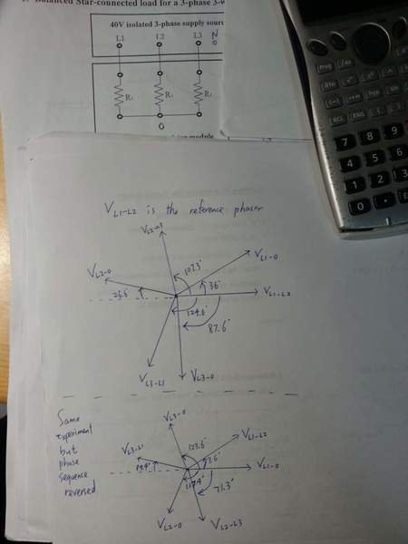

Lab-3 phase star connected system
go2255
Is common point(O) equal to netural terminal?
eg: Vo=Vn??
V(L1-o)=V(L1-n)??
The first one is what I measured in a lab.
The second one my prediction if the phase reversed,base on the first one
is it reasonable?
Point O is the star-point. There will be no voltage difference between Point O and the neutral lead providing all is perfectly balanced.
When O is not connected to neutral you have a floating star-point.
