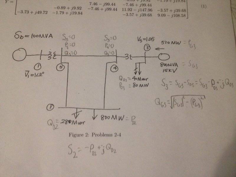

I'm having trouble determining what the values are on my Power Analysis diagrams. I get confused with active power, reactive power, and complex power.
Can someone take a look at my attachment and tell me if I labeled the values correctly?
I'm mainly curious as to if my Sg3 value is correct and if I can calculate Qg3 in the way that I have.
And what does the 15kV, under the 800MVA, mean? How would I use that value when solving the power flow problem with Gauss-Seidel method, Newton-Ralphson method, or fast decouple method?

How can people check your work when the picture you attached has only part of the problem? Also, see the homework guidelines (https://www.physicsforums.com/threads/guidelines-for-students-and-helpers.686788/), especially 5 and 8.
