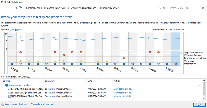

You should check the Relibility Monitor to see what errors have been logged. I access it by typing reliability monitor in the small search box in the lower left of my Windows 10 screen, but you can access it via the Control Panel as well. You can see that there have been some errors recorded in my recent history (I'm also on an HP laptop about the same age as yours). Click on each error to get a more detailed description below the timeline display.

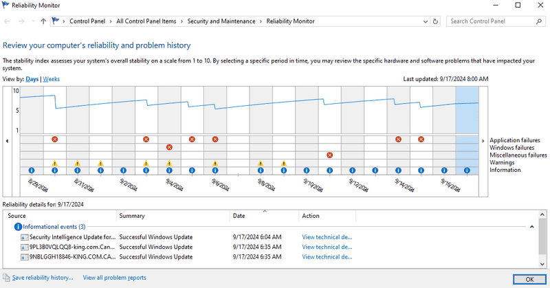

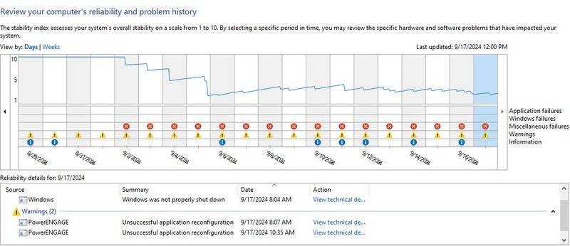

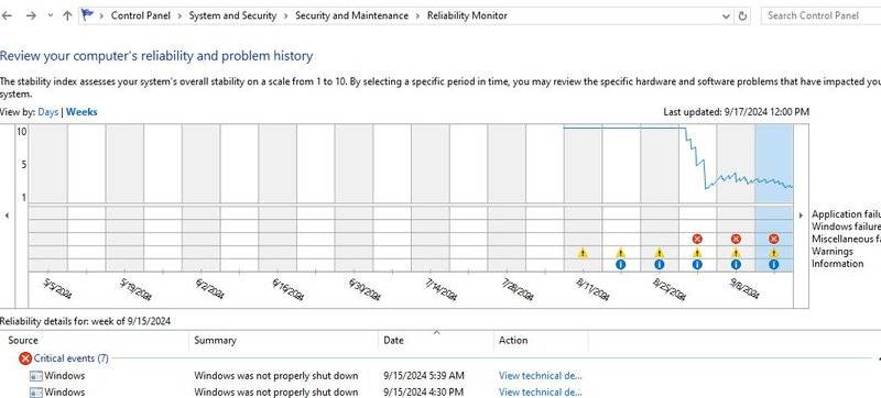

I ran the reliability report, it just show the shutdown, nothing new. Attached are two screen shot, one for weeks and one for days.

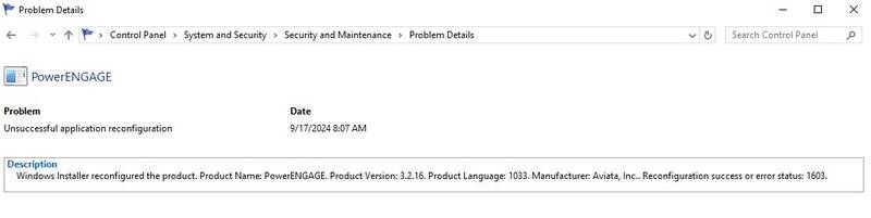

What's that PowerENGAGE thing?
Here is what I got:
It starter after I set never power off on battery last night.
I went online, it's about battery usage, setting and all that. The battery charge is 0%, the battery is dead.

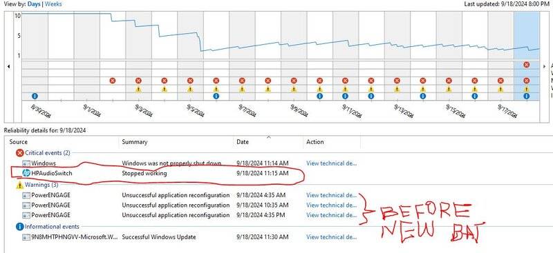

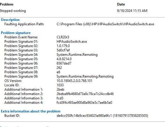

I still see problem in the reliability report after 9hrs. Here is the screen captures of the report and the one that describe the problem. I have no idea what those stuffs are in the detail on the fault.
This is the description of the fault.
Anyone can help?

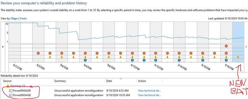

The laptop did not fail for 24hrs. BUT the reliability report still showing it's not up all the way. But the report show no error. This is the reliability report today.
There only a yellow "!", no more failure.
I am looking at the PowerENGAGE, I search on computer and went on line. I don't know exactly whet it is for, Can I delete the whole folder, I don't even think it's being used.
