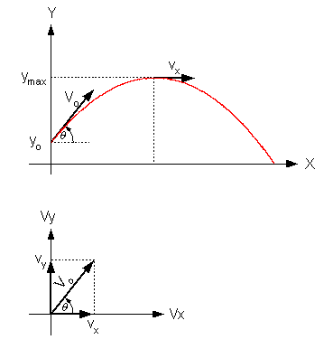

A potato of mass 210 g is launched from a potato gun, being released from a height of 0.6 m, at an angle of 47o with respect to the horizontal, and with an initial speed of 38 m/s. Assume the effect of air resistance can be neglected.

a. What is the horizontal component of the potato’s velocity at the time it is launched?
A) You can separate the velocity into two vectors, let's say vx and vy. The find the horizontal velocity, you simply make a triangle with the vinitial as the hypotenuse with an angle of 47 degrees. Use vinitialsin(x) to find vx (the horizontal velocity). All this is assuming there is no air friction.

Consider the two figures here:
The first shows the trajectory of your projectile plotted on X-Y axes. The initial launch speed is indicated as Vo and the initial launch angle is θ. Note that a quantity with both magnitude and direction is a vector quantity. So we can call Vo with its angle the initial velocity vector.
The second drawing shows the velocity vector drawn on a set of axes that represent the vertical (y) and horizontal (x) components of a velocity. What are the projected lengths of this vector on the axes? That is, what are Vx and Vy? You'll want to use a little trigonometry.
Something to note is that while the velocity in the y-direction changes due to the acceleration due to gravity, the velocity in the x-direction is constant throughout the trajectory.

[QUOTE ... find the horizontal velocity, you simply make a triangle with the vinitial as the hypotenuse with an angle of 47 degrees. Use vinitialsin(x) to find vx (the horizontal velocity)... QUOTE]
If x is 47deg then sin must be replaced by cos.
[QUOTE ... Since vx is 0m/s at max height we can neglect that and use vy[/QUOTE]
May I correct some typos:
If v[itex]_{x}[/itex] is meant to be the horizontal component of the velocity, then vx must be replaced by vy and vy by vx.
