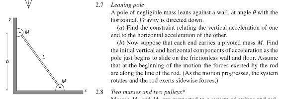

This is a problem from Mechanics by Kleppner and Kolenkow1. Homework Statement
Two identical masses M are pivoted at each end of a massless pole of length L. The pole is held leaning against frictionless surfaces at angle θ, as shown, and then released. Find the initial acceleration of each mass.

The answer looks right (after setting mu to 0), but there's an easier way.
Let the accelerations be ax and ay. Resolving along the ladder they must have the same component: ##a_x\sin(\theta)=a_y\cos(\theta)##.
Take moments about the point where the two normals intersect (so they don't figure in the equations). ##MgL\sin(\theta)=Ma_xL\cos(\theta)+Ma_yL\sin(\theta)##.

The OP did not define y explicitly, but appears to have taken it as the height of the top of the pole. If you define it differently you will get a different equation.

b? You mean L? By dimensional analysis, it cannot feature in the answer. Only g and theta can be involved.

I may have taken theta to be the complement of that intended. Looks like I took it as the angle to the vertical, and y measured down from the top, as you have.
What is the component of ay along the pole? What is the component of ax along the pole? How must they be related?

Ok, that was not shown in this thread. Anyway, same story - it cannot feature in the answer, other than replacing functions of theta by functions of b/L.
rivendell said:
if I can assume that motion exerted by the rod is in line with it as was stated there
You mean force, yes? I don't understand the book's remark about the force only being in line with the rod at the start. If the rod has no mass, the forces it exerts must always be along it. Consider moments about one end of the rod.
