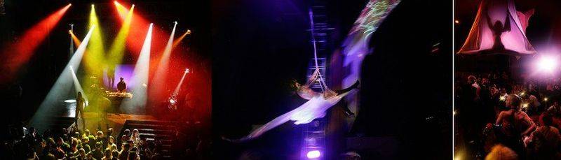

Thanks for answers. I think I should clarify. This issue pertains to stage and event lighting, not to studio at all, and I suspect the competence and knowledge of hte lighting designers and operators is a huge factor. And a;lso, I think there is a big difference of approach between "stage" and "event" lighting, oh, and this applies tio analogue or digital equally, (unless we are dealing with flicker)
So, I need to purchase and play with some leds, it's clear they are here to stay but in the meantime,
I'm uploading a composite image that may illustrate my point...
The colorful image on the left was from an old style dance hall shot in 90's, (not manipulated) the two on the left are modern leds. They are not as bad as I have, and also, the have other forms of lighting present, when the light becomes a solo color from every source is a factor too,

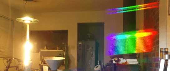

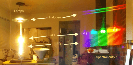

Way to ruin my "sciencey" followup answers...
:oldgrumpy:
Wow, why ruin? that's amazing, looking at it... give me a mo
Damn, that brilliant, dang, damn wow. (sorry, new, can I curse like that?
you have no idea how you just made my day, week and month!
That's exactly the problem. :)
Acknowledged :)
