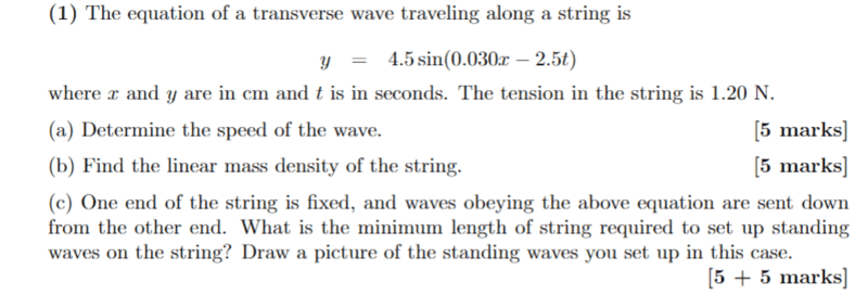

v = fY, where Y is lambda

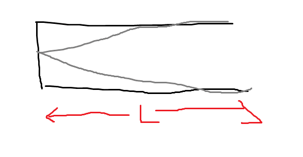

In part (c), I have no problem if the string could stretch, but consider an inextensible string. This could still form a standing wave, according to google.
But then how is the string (the wave) equal to L? So can we actually equate lambda/4 with L? i.e. it is curved and varies with amplitude.
In addition, I don't understand how if you have an inextensible string fixed between two points (a different scenario), how you can even pluck it. Because surely this will stretch the string? But the string is inextensible!
The string is an object. Length is a property. It doesn't make sense to say they are equal.
Perhaps you mean wavelength? That is not equal to ##L##. The wavelength is equal to ##4L##.
That figure greatly exaggerates the curvature of the string. We are using an approximation where the amount of curvature is negligible. (See below for further explanation).
I didn't notice this at first, but the standing wave you have drawn is not possible for a vibrating string. Both ends of the string have to be fixed, that is, they must be displacement nodes. Thus you cannot have a quarter of a wave.
What you have drawn is possible for other wave-carrying media, such as a sound wave in air (the so-called open pipe) but not for a string.
I know that the problem states that one end of the string is fixed, but it doesn't say only one end is fixed. It's kind of a trick question. Either that, or it's nonsense.
This is incorrect. It depends on the type of boundary condition you impose. It is certainly possible to have Neumann boundary conditions on either end.
Edit: If you have access to my book, Example 3.14 discusses how Neumann boundary conditions arise for the case of a vibrating string.
See above.
laser said:
When waves are being sent down from the other end, e.g. by moving your hands up and down, is that not an antinode? I kind of see your point though - by barely moving your hands it would still oscillate, and you could consider both ends a node. But what happens if you move your hands a noticeable amount, such that it is equal to the amplitude? Or is this possible?!
The above being said, the forcing motion of one end will fix the position of that end. This will lead to excitations of the modes where the end points are indeed fixed so in this particular case, the minimum wavelength is L/2 and not L/4.
