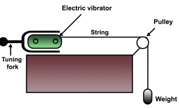

Please see below picture. In my notes, as the frequency of electric vibrator is increased, there will be more nodes produced and the amplitude will be less.
##y=2A \sin kx \cos \omega t##
Diagram of a standing wave apparatus: a tuning fork with an electric vibrator on a string running over a pulley to a hanging weight, with the string stretched across a rectangular box.
I understand the part where there will be more nodes produced because number of wave produced will increase (let say from half wave to one wave). But I don't understand the part where the amplitude will be less. How can number of nodes (or frequency) affect the amplitude of standing wave produced in the string?
Thanks
The power supplied to the string by the vibration generator is proportional to pressure and particle velocity. If the power remains constant, the velocity remains constant as frequency is altered . But as frequency is increased, the distance traveled in each cycle is less because the time is less. The power in a sound wave is found by multiplying the pressure wave by the particle velocity wave. So the "amplitude" of the wave is either the pressure or the velocity but not the distance of vibration.

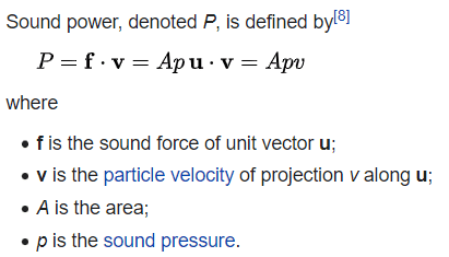

Is this the formula you mean? I found it in wikipedia
Wikipedia-style text defining sound power P = f·v = Ap u·v = Apv, with bullet definitions: f is sound force, v particle velocity, A area, p sound pressure.
If that is the formula, then if power and velocity remain constant, then the sound pressure will also remain constant since the area will also be constant?
Sorry I don't really understand this part.

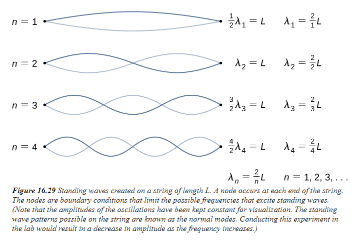

I found something similar to my question in this link:
https://opentextbc.ca/universityphysicsv1openstax/chapter/16-6-standing-waves-and-resonance/
Four standing wave patterns on a string of length L for n = 1 to 4, each with fixed ends; labels give half-wavelength relations and wavelengths lambda_n = 2L/n for n = 1, 2, 3, ...
That is part of text in the link above. The last sentence in explanation of Figure 16.29:
"Conducting this experiment in the lab would result in a decrease in amplitude as the frequency increases."
It seems to me that the amplitude referred by the text is the vertical displacement of the particle. But I don't understand why the amplitude will decrease as the frequency increases
This wording suggests it is a 'real world' effect rather than a theoretical one in an idealised model.
Lateral displacement will create some longitudinal displacement too. This will increase at higher frequency as that increases the path length along the string.
This is not a sound wave, it is a transverse (standing) wave on a string at constant tension. The energy in the string is easiest to calculate when it is all kinetic and $$E~\alpha~ A^2\omega^2$$ so for a fixed energy density in the wave the result is evident.
In practice the details of how the wave is driven and how it loses energy will be determinative
