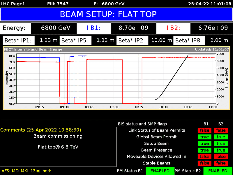

New beam-energy world record this morning with the first ramp of pilot beams to 6.8 TeV

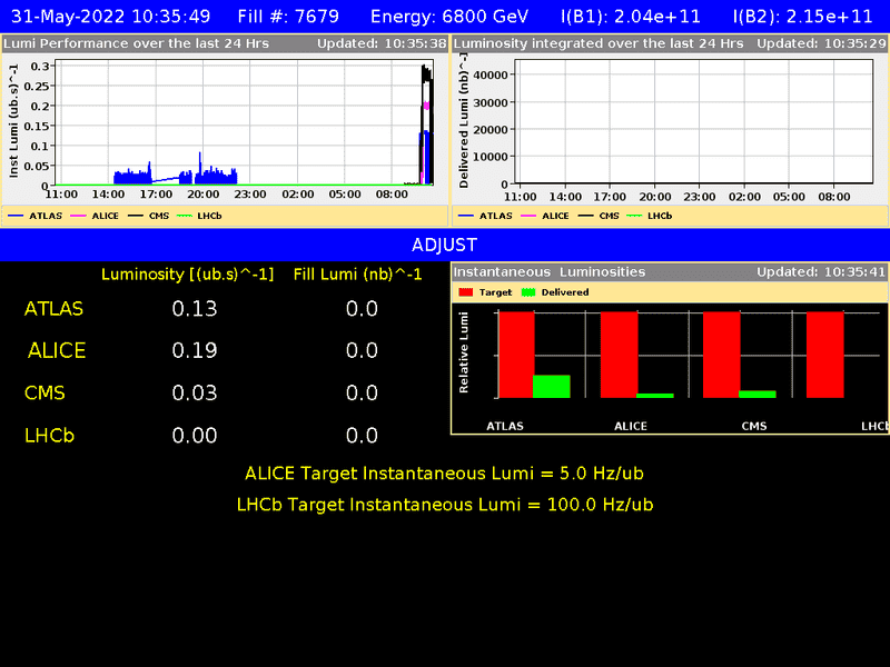

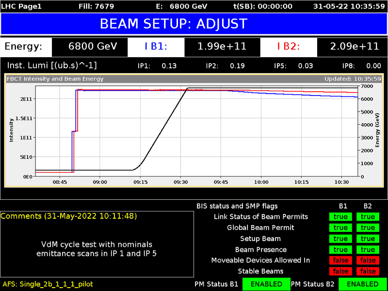

First collisions with 6.8 TeV per beam (for van der Meer scans). First "stable beams" at this energy are still 5 weeks away

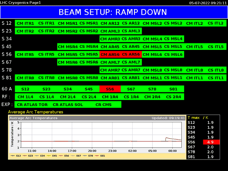

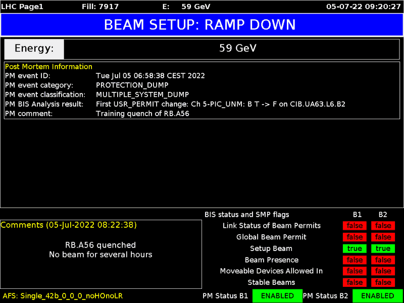

... and we start the day off with 7 magnet quenches (6 dipoles and a quadrupole)
First estimate for recovery of the cryogenic conditions is 15:00. The plan was to have beams in "adjust" by 13:00. We might be waiting around a bit.

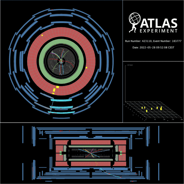

The experiments have been posting event displays of 13.6 GeV collisions. They look a lot like 13.0 GeV collisions. :smile:
