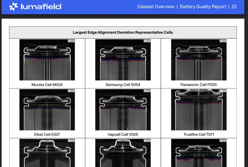

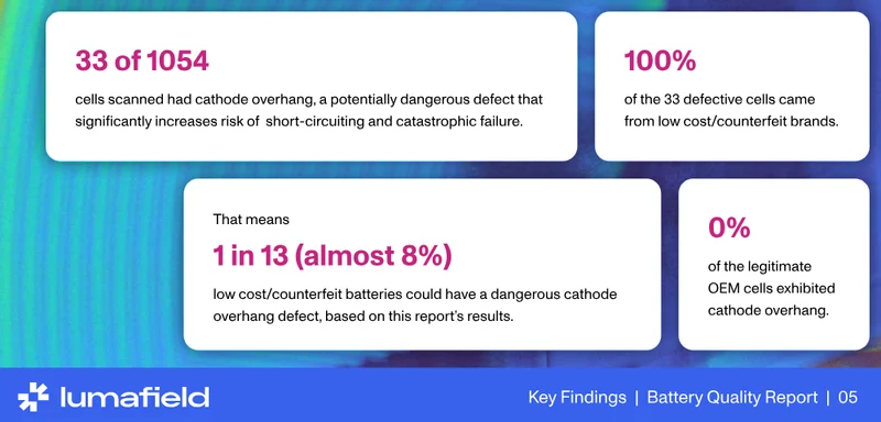

OK, I guess I'm only buying name brand batteries now.
Lumafield makes CT scanners for industrial engineering and production testing. They've released a report on the quality of Li-Ion batteries that they surveyed (18650 cells), which I thought was really interesting.
https://7802750.fs1.hubspotusercont...Guides/Batteries/Lumafield Battery Report.pdf
Yikes!
Given the fire risk of lithium, there is little reason to go cheap.
Regulated and enforced safety standards seem necessary, ie the cheap counterfeits should be detected and rejected. De-funding regulatory agencies and industry 'self regulation' looks short sighted; I suspect the insurance industry favors enforced standards as will most of the major manufacturers.
A lot of cheap batteries have exaggerated capacity as well, so not such a bargain as might seem even before considering expected working life and fire risks.
Not sure it is useful to go by averages for determining our risks; whilst I may have some items that may contain poor quality batteries (a cheap electric shaver comes to mind) most of the batteries come from reputable sources. The largest (solar batteries and electric ride on mower) are LFP type that are less flammable. Seems possible we'll see a shift to sodium chemistry - they are coming onto the market and whilst not having the storage density of NMC are not much short of LFP and CATL is claiming very long working life (5,000 to 10,000 cycles) and superior low temperature operation.
But there are a lot of batteries already in most homes with more all the time and just by their numbers the risks rise - and not only from battery faults; chargers for them as well as the things they power have fire risks.
