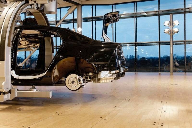

The train platform is raised to first floor level and this can't be altered. The concept of the facade of the building is to celebrate the delivery process and the sense of movement within a factory. Instead of the current trend of screens creating sheds on the landscape I wish to use similar principles to those demonstrated at the 'Transparent Factory' in Dresden.
So passers walking by or using the train, witness this horizontal flow of cycles riding through the building on a vertical and horizontal plain. Couple with the vertical and horizontal flow of freight.
