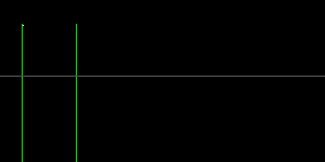

I made a simulation which shows what i meant. I depict the coordinate-age of light by its y-coordinate. It's a horizontal light beam between two accelerating mirrors (constant proper acceleration). The left mirror-right mirror-left mirror trip of light takes more coordinate-time when the mirrors have gained some velocity.
Oh now I remember that what I was saying earlier was that large enough proper acceleration results in increased coordinate round trip time. In my animation increasing coordinate round trip time is correlated with increasing velocity - which is correlated with increasing time, and would be correlated with increasing proper acceleration, if there was any increasing proper acceleration.
Right. So the process I proposed in #23 will do this for you analytically.
