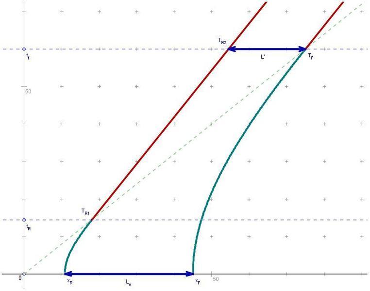

In other threads the topic of how the proper time of a clock under acceleration has come up a number of times so I have decided to analyse this subject in a little more detail.
For this analysis we have these conditions:
a)Two clocks are initially at rest separated by a distance [itex]L_o[/itex] along the x axis.
b) Both clocks are simultaneously born-rigid accelerated along the x-axis (maintaining constant proper separation).
c) The experiment happens in flat space.
d) When the rear clock reaches velocity v relative to the initial frame it stops accelerating and maintains constant velocity v.
e) When the front clock reaches velocity v relative to the initial frame it stops accelerating and maintains constant velocity.
f) In the final state both clocks have constant and equal velocity and are separated by the proper distance [itex]L_o[/itex]
Referring to the attached diagram:
[itex]a_F[/itex] is the acceleration of the front clock proportional to [itex]c^2/x_F[/itex]
[itex]a_R[/itex] is the acceleration of the rear clock proportional to [itex]c^2/x_R[/itex]
[itex]t_F[/itex] is the coordinate time that the front clock clock takes to get to velocity v.
[itex]t_R[/itex] is the coordinate time that the rear clock clock takes to get to velocity v.
The dashed green line from the origin going through [itex]T_{R1}[/itex] and [itex]T_F[/itex] is a line of simultaneity in the accelerated clock frame.
The red lines are constant velocity phase after the acceleration phase.
When the front clock stops accelerating the proper time that has elapsed ([itex]t_f[/itex]) is given by the formula:

The rear clock accelerates faster and gets to velocity v quicker than the front clock. The proper time that elapses from the coordinate time the rear clock stops accelerating to coordinate time that the front clock stops accelerating is simply the coordinate time difference adjusted by the Lorentz factor:
(Eq 3) [tex]T_{R2} - T_{R1} = (t_f - t_r)\sqrt{1-v^2/c^2}[/tex]
The difference in proper time between the front clock and the rear clock after accelerating is given by
(Eq 4) = (Eq1) - (Eq 2) - (Eq 3)

By substituting (Eq 5), (Eq 6) and (Eq 7) into (Eq 4) and solving the time difference between the front and rear clocks as seen in the initial frame is given by:
(Eq 8) [tex]T_F - T_{R2} = {-L_o v \over c^2} + {L_o \over c} \sinh^{-1} \left({ v \over c \sqrt{1-v^2/c^2}} \right)[/tex]

Very interesting, nice work.
How do you reconcile (eq3) with the fact that, as seen from your Minkowski diagram:
[tex]T_{R2} = { c \over a_R} \sinh^{-1} \left({a_R t_r \over c} \right)[/tex] ?

The rear clock maintains constant velocity from [itex]T_{R1}[/itex] to [itex]T_{R2}[/itex] (the straight diagonal red line) so the hyperbolic motion equations are not required for that segment and the straight forward Lorentz transformation of the time inteval is sufficient to obtain (Eq 3).
The total proper time experienced by the front clock is given by (Eq 1)
The total proper time experienced by the rear clock is (Eq 2) + (Eq 3)
The rear clock has a combination of hyperbolic motion and constant velocity.

OK, I understand, you have some typos in the text and in the diagram that threw me off.
So, you are trying to calculate [tex]Ttotal_F-Ttotal_R[/tex], right?
But, in eq(8) you are calculating:
[tex]Ttotal_F-T_R_2[/tex], unless it is another typo?
Yes
[tex]Ttotal_F-Ttotal_R = (Eq 1) - (Eq2) - (Eq 3) = T_F - T_{R1} - (T_{R2}-T_{R1}) = T_F - T_{R1} - T_{R2} + T_{R1} = T_F - T_{R2}[/tex]
So
[tex]Ttotal_F-Ttotal_R = Ttotal_F-T_R_2[/tex]

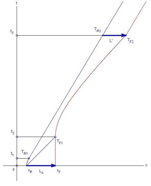

As far as I can tell the equation I derived in post #1 is correct but unfortunately (for me) I have found a counter example to my own conjecture that I added to the end of the post. “It is further conjectured that there is no acceleration scheme that can keep two spatially separated clocks synchronised when transferring the clocks from one inertial reference frame to another. ( peh! :P) I have found that if we allow for the propagation delay of the acceleration impulse along the length of a rear engined rocket and allow the rocket to compress well beyond its natural length contracted length then it IS possible to find an acceleration pattern that keeps the clocks synchronised. This acceleration pattern allows the clock at the nose of the rocket to follow a longer path through space-time and time dilate to a lesser extent than the rear clock. In the attached diagram the front of the rocket does not start accelerating until coordinate time t2 which is later than the coordinate time t1 when the rear of rocket has finished accelerating. This is because of the minimum time for a signal traveling at light speed to propagate from the rear to the front. In practice this delay would probably be even longer if the impulse wave propagates through the material at the speed of sound.

Accelerating while maintaining constant proper separation is the definition of born-rigid acceleration which is probably the most used acceleration method used in discussions of accelerating rockets. It is admittedly an ideal situation that is probably not often found in nature except as an approximation. The result that clocks go out of synchronisation under ideal born-rigid acceleration is not obvious to everyone.
Thank you, I know very well what Born-rigid motion means. I was commenting about why [tex]a_R[/tex] and [tex]a_F[/tex] do not show in eq(8). Speaking of eq(8), I did not redo your calculations but the fraction [tex]\frac{L_0 v}{c^2}[/tex] looks very suspect since the result is made up of irrational expressions (square roots and sinh). The only way you may arrive to the rational term is if you did some approximations.
You may want to double-check eq (8), it may not be correct.

The expression [tex]\frac{L_0 v}{c^2}[/tex] comes directly from substitutions into
which does not contain the transcendental sinh function.
By re-writing the rhs of (Eq 3) as
(Eq 11) [tex]\left(t_f\sqrt{1-v^2/c^2} - t_r\sqrt{1-v^2/c^2}\right)[/tex]
and substituting [tex]t={v \over a\sqrt{1-v^2/c^2}[/tex] into (Eq 11) we get
(Eq 12) [tex]{v \over a_F} - {v \over a_R}[/tex]
then substituting [tex]a_F = {c^2a_R \over (L_0 a_R +c^2)}[/tex] into (Eq 12) we get
(Eq 13) [tex]{v(L_0a_R+c^2) \over c^2a_r} - {v \over a_R} = {vL_0a_r+vc^2-vc^2 \over c^2a_R} = {L_0 v \over c^2}[/tex]
Nothing too dodgy there I think.

Thank you, this explains very well my point about the solution being independent of [tex]a_F[/tex] and [tex]a_R[/tex] due to imposing that:
-proper separation [tex]L_0[/tex] is maintained
-both clocks arrive to the same terminal speed [tex]v[/tex]
