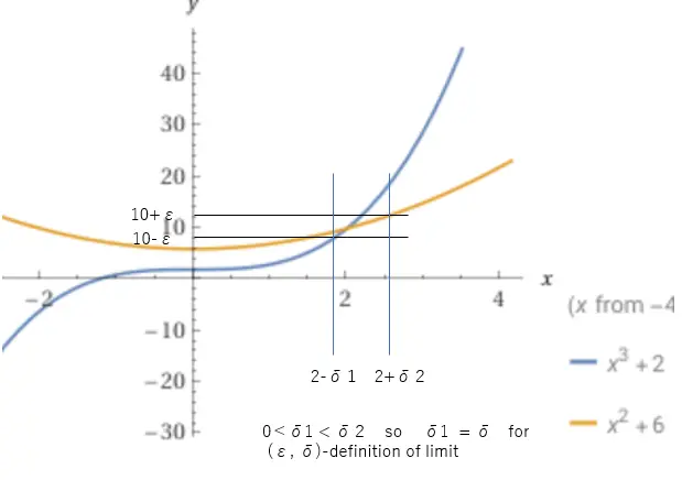

I have used an online graphing calculator tool and I have found that $$ \delta=|\sqrt[3]{8+\epsilon}-2| $$. I am doubtful about finding ## \delta ## easily. By the way, the original poster can always follow the recommendation in the post #13.

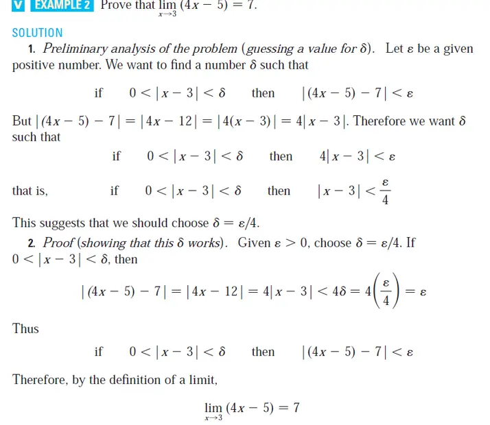

Oh ok, but how about something like this?
That example is from textbook and there is part 2 of the working (to show that this ##\delta## works). Is this part not needed and I can just stop at part 1 after stating ##\delta=\frac{\epsilon}{4}##?
I can't say with authority whether part 2 is required. I am not a "proof policeman". If part 1 had stated things differently, like using the minimum rather than saying ##\delta = \epsilon/4## was a "guess", I would have considered part 1 to be enough of a proof.

Please find below the plots of my understanding the situation. I hope it is not wrong and has some meanings.
