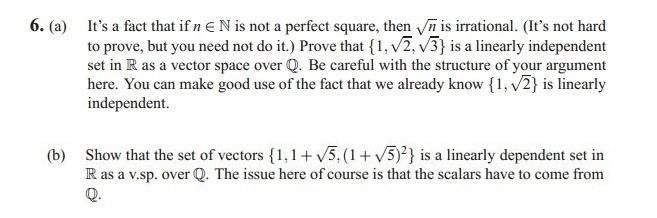

For part (a):
a*1 + b*√2 + c*√3 = 0
assume a, b, c not all zero
a + b√2 = -c√3
a2 + 2b2 + 2ab√2 = 3c2
a2 + 2b2 - 3c2 = -2ab√2
(a2 + 2b2 - 3c2)/(-2ab) = √2
which is not possible since we take a, b, c to be rational, and √2 is irrational.
thus our assumption of a, b, c not all zero was false and we must have a=b=c=0.
For part (b), a similar argument, but easier:
{1, 1 + √5, (1 + √5)2} = {1, 1 + √5, 1 + 2√5 + 5}
a + b(1 + √5) + c(1 + 2√5 + 5) = 0
1 + b + b√5 + c + 2c√5 + 5c = 0
1 + b + c + 5c = -b√5 - 2c√5
1 + b + 6c = (-b - 2c)√5
(1 + b + 6c)/(-b - 2c) = √5
same story as before.
Now that was super easy. And the assignment says to be careful with the structure of my argument. And I hate denominators because they can't be zero. If a = b = c = 0, then we have 0/0, which is of indeterminate form, which is ok! but I'm getting the idea that my argument is flawed because of division by zero...

Looks OK to me ... a,b,c not all zero is required for linear independence anyway.
For part b, note that your set is {1, 1 + √5, 6 + 2√5}. Clearly the third "vector" is a linear combination of the first two in the list.
yeah i was so caught up in things that i forgot to combine the 1 and 5, thanks everyone.
