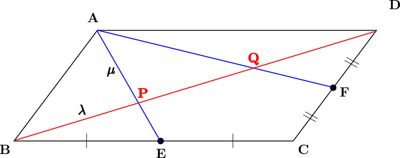

Use vector methods to show that two lines from one vertex of a parallelogram to the midpoints of the two opposite sides trisect the diagonal. (Additionally, if I may add, show that the diagonal itself trisects both those lines.

I begin by drawing the image of the problem to the right. ABCD is a parallelogram with diagonal BD. Points E and F are midpoints of BC and CD respectively. AE joined meets BD at P and AF joined meets BD at Q. Let the ratio ##\dfrac{\text{BP}}{\text{BD}} = \lambda## and ##\dfrac{\text{AP}}{\text{AE}} = \mu##. I am required to show that ##\boxed{\boldsymbol{\lambda = \dfrac{1}{3}}\quad\left(\text{and}\;\mu=\dfrac{2}{3}\right)}##.

Let the position vectors of each point in capitals be given by its equivalent in small letters, with respect to an arbitrary origin chosen anywhere say O. Thus, for instance, the position vector of A is ##\vec a##, etc. Hence, using (1) of the relevant equations (R.E.) above, I find that the position vector of E is ##\vec e = \dfrac{\vec b+\vec c}{2}##. Using (2) from the RE's above, the vector ##\vec{\text{AE}} = \vec e -\vec a = \dfrac{\vec b+\vec c}{2} -\vec a = \dfrac{\vec b+\vec c-2\vec a}{2}##. Thus the vector ##\vec{\text{AP}} = \dfrac{\mu}{2}(\vec b+\vec c-2\vec a)\qquad\mathbf{(1)}##
Likewise, the vector ##\vec{\text{BP}}= \lambda(\vec d-\vec b)\qquad\mathbf{(2)}##.
But since ##\vec{AB}+\vec{BP} = \vec{AP}\Rightarrow \vec b - \vec a + \lambda(\vec d-\vec b)=\dfrac{\mu}{2} (\vec b+\vec c-2\vec a)\qquad\mathbf{(3)}##, upon using (1) and (2) above.
The (position) vectors appearing in (3) are not all independent. Since ABCD is a parallelogram, ##\vec{AB} = \vec{DC}\Rightarrow \vec b-\vec a = \vec c-\vec d\Rightarrow \vec d = \vec a-\vec b+\vec c\qquad\mathbf{(4)}##.
Using (4), (3) simplifies to ##\vec b -\vec a+\lambda(a-2\vec b+\vec c)=\dfrac{\mu}{2}(\vec b+\vec c-2\vec a)\Rightarrow (\lambda-1-\mu)\vec a+(1-2\lambda-\mu/2)\vec b+(\lambda -\mu/2)\vec c=0\qquad\mathbf{(5)}##
If we assume the vectors ##\mathbf{\vec a, \vec b, \vec c}## to be L.I., their coefficients should be zero. Thus ##\lambda-\mu = 1\, , 2\lambda+\mu/2 = 1\; \text{and} \lambda = \mu/2\Rightarrow\mu = 2\lambda##. This yields ##\boxed{\lambda=\dfrac{1}{3}\;\text{and}\;\mu = \dfrac{2}{3}}##, which solves the problem.
