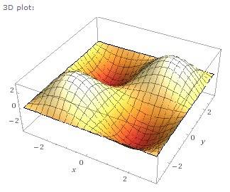

Here is the question:
Find the local maximum and minimum values and saddle point(s) of the function. If you have three-dimensional g?
Find the local maximum and minimum values and saddle point(s) of the function. If you have three-dimensional graphing software, graph the function with a domain and viewpoint that reveal all the important aspects of the function. (Enter your answers as a comma-separated list. If an answer does not exist, enter DNE.)
f(x, y) = 3 sin x sin y, −π < x < π, −π < y < π

Here is a plot of the given function on the stated domain, showing all 5 points:
Here is a link to the program I used to plot the function:
z=3sin(x)sin(y) where x=-pi to pi,y=-pi to pi - Wolfram|Alpha
