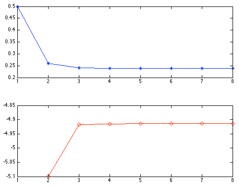

When applied for $x = [6,52,28,14]$ and $n=100$ I get the following plot.
I'll try to make sense of it tomorrow. Any insight is appreciated!
  • Two stacked line plots over iterations 1 to 8: the upper blue curve with asterisk markers drops from about 0.5 to about 0.24 and levels off; the lower red curve with circle markers rises from about -5.1 at iteration 2 to about -4.92 and levels off.

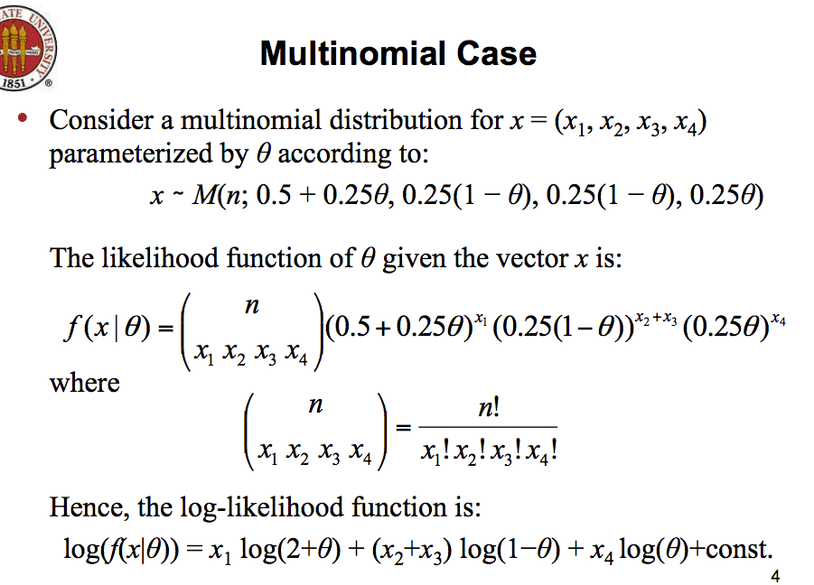

Yep, you are correct. Here is a screenshot of the slide with this example problem.
Good point about the function being a function of $\theta$ and not $x$. It makes more sense now why we group of the terms not containing $\theta$ into one constant term.

  • Slide titled Multinomial Case: multinomial distribution for x = (x1, x2, x3, x4) with probabilities 0.5 + 0.25θ, 0.25(1 − θ), 0.25(1 − θ), 0.25θ, the likelihood function, and the log-likelihood expression x1 log(2+θ) + (x2+x3) log(1−θ) + x4 log(θ) + const.

It appears they have turned it into an algorithm that approaches $\theta$ such that it has the maximum likelihood.
The result is $\theta \approx 0.24$.
The second graph might be of $\log \theta$ I guess.
It looks a bit convoluted to me though.

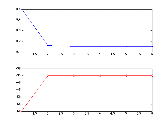

I believe you are looking at the example problem. The problem I was given to solve was $x \sim M(n;0.25\theta,0.25\theta(2+\theta),0.5(1-2\theta),0.5\theta)$. Does my log likelihood function look good now? (by the way I realize now I never explicitly gave the distribution for the problem I need to solve so this mix up is definitely my fault!)
The method you used is something I've seen but we were told to always partition one of the variables into two others, although I'm not really sure why. It seems like once you do this it is normally referenced as "complete data".
Anyway, when using the probabilities from the example instead of the ones in this post I get the following graph which seems to have the same result as the one you got. You are correct that the second graph is a log plot.
If your method works the same then I don't understand why I have to go through this tedious mess of partitioning one variable to get "complete data". On page three of this pdf they use both methods it seems. :confused:
  • Two stacked line plots over iterations 1 to 6: top, a blue starred curve dropping from about 0.5 to about 0.15 then flattening; bottom, a red circled curve rising from -60 to about -35 then flat.
Yes. Then it looks perfect. :)

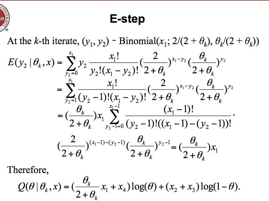

Here is the slide concerning the "E step" of the EM algorithm in the example problem. I really want to know if this process can be simplified. I will continue reading and try to find out but on the quiz we had today I couldn't do this step. :(
  • Slide titled E-step deriving E(y2 | theta_k, x) as a binomial sum, simplifying to (theta_k/(2+theta_k)) x1, ending with Q(theta | theta_k, x) = ((theta_k/(2+theta_k)) x1 + x4) log(theta) + (x2 + x3) log(1 - theta).
Which sub step in this "E" step is causing you problems?
Or is it that an "E" step is used at all?
