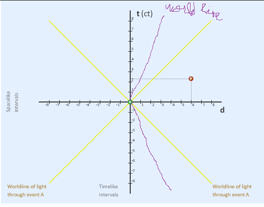

And another thing, be the red point this spacecraft , the purple line the world line with slope = 2 and the green point a photon thrown towards the Earth from the spacecraft , would this spacetime diagram ok? (distance would be 1.2 billion km, and the time, 1000 times of shown, but scale is badly displayed, even the red point wouldn't be at that position, but I did it like this just for showing it).
