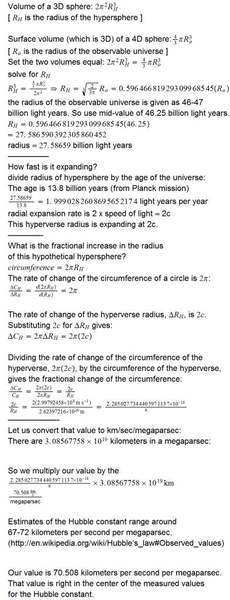

I have the details, with equations, attached.
1. The hyperverse radius is about 27.59 billion light years.
2. the speed of radial (4th dimension) expansion is 2c, twice the speed of light.
3. The fractional increase of the hyperverse circumference matches the Hubble constant.

To Marcus...from your first post..."3D hypersphere is immersed in 4D space"
I think you missed the whole idea. I am talking about a hollow, expanding, 4D sphere. It surface would be three dimensional, our universe. If we take the volume of the observable universe (with us in the center of a 3D sphere), and then ask "if our 3D spherical universe is the actually the surface volume of a 4D sphere, how big is this 4D sphere?"
The answer is that the radius of this hypothetical, expanding, hollow, 4D sphere would be about 27.59 billion light years.
Given an age of about 13.8 billion years, this hypothetical "hyperverse" would be expanding at, what appears to be exactly, twice the speed light.
Now, let me address the immediate thought... relativity applies to motion within the universe. This is not motion within the universe.
The 2c radial expansion rate suggests that the speed of light is a function, one-half, of the rate of radial expansion. It is the radial expansion of space that determines the speed of light.
And this should suggest to you that the radial expansion of space is the foundation of time.
But let us continue.
What is the fractional increase in the circumference of this hypothetical hyperverse? By 'fractional', I mean the total increase in the circumference, divided by the total circumference. This gives us the increase per point along the circumference.
The answer is the Hubble constant! And that is a powerful result.
Remember that the Hubble constant is given in terms of distance per time per distance. The distances cancel out, and at its core, the Hubble constant is a dimensionless number per unit time. So there is no inherent conflict in speaking of the Hubble constant being the rate of circumferential expansion.

The initial conditions are wrong. Even if the model of our universe as the surface of a 4D hypersphere were correct, the radius of said sphere at the time inflation ended is unknown. There may also be a mistake in how you estimated the radius changes over time (In reality, ##R_c \propto a^2##), but I didn't look in detail at what you did.
Given the hypersphere model, the way you'd get at the radius would be to measure the spatial curvature. The radius of curvature at the present time can be defined as:
[tex]R_c = {c \over H_0\sqrt{\Omega_k}}[/tex]
Here ##\Omega_k## is the fractional difference between the true energy density of our universe and the critical density (which is a function of the expansion rate). This parameter is currently measured to differ from zero by no more than about 0.005. This corresponds to a curvature radius of about 200 billion light years, at a minimum.

If I correctly see what you did there, you took the observable universe and you mapped it onto a 3-sphere hyperarea for no apparent reason. Unless you think the observable universe is the whole universe(it isn't).
It's like taking your home town, and mapping it to the surface of a sphere so that it's fully covered, and then trying to come up with conclusions about geometry of the Earth. You'll get nonsensical, or "eye-catching" results as well.
The correct approach is to measure the curvature first, then use it to find the radius - which is what Marcus and Chalnoth have talked about(by the way it's >200 Gly now? I always seem to be 30% behind the current best measurements).

There's no conclusion here because you are just arbitrarily mapping the observable universe to the surface of a hypersphere for no real reason. If we assume that the universe is larger than the observable universe (we have no reason to believe otherwise, and I've read about evidence suggesting that the universe is at least several tims larger than the observable universe) then none of this is correct. Furthermore, the speed of light has nothing to do with the expansion rate of the universe. It is a local speed limit, not a cosmological speed limit, and the expansion rate of two opposite sides of a hypersphere should have nothing to do with the speed limit along its surface.

Let me point out a math error as well.
You took a 3d euclidean space and mapped it onto a non-euclidean 3-sphere as if it were an euclidean space too.
It might be easier to visualise by taking the dimensions one notch down.
Say you've got a flat surface, on which you draw a circle or radius ##R_0##. The area enclosed by the circle is the observable universe, and equals ##\pi R_0^2##.
You want to map it onto a regular, 3-dimensional 2-sphere and find out what is its radius ##R_H##.
To do that, you say the area of the 2-d observable universe and the surface area of the sphere must be equal. ##\pi R_0^2=4\pi R_H^2## from which follows that ##R_H=1/2 R_0##.
However, now let's try and find what is the distance between the same observer and the edge of the universe before and after mapping.
Before, it's just ##D=R_0##. After, it's half the circumference ##D=\pi R_H##.
Which leads to ##R_0=\pi R_H##. Substituting earlier calculations, we get ##R_0=1/2\pi R_0##.

My issue isn't that you are mapping the universe onto the surface of a hypersphere, but that you are mapping only the observable universe onto this surface.
——Response, part 1: The ‘no reason to believe it is larger’….. The universe is measured at about 13.8 billion years old. How long has the light been traveling to us? Not that whole time. The universe grew during that 300,000 or so years before it could move freely, and it grew a lot. We only see to the edge of the ‘fog’, so to speak. The fog bank is large.
I said that there's no reason to believe that the universe isn't larger than the observable universe, not that there's no reason to believe it is larger. In other words, the universe as a whole should be larger than just the part we can see.
——Response, part 2: If the universe is larger than what we see, the fact remains that a hyperverse the size of the observable universe is expanding hyper-radially at 2c, and circumferentially at the Hubble constant. I am still working on what that means, but the observation stands. You can, and are, trashing it, and that is fine with me, but the observation needs to be placed out in the open. It means something. Maybe our measurements are some how tied to the size of the observable universe. But this is no coincidence; it is telling us something if we listen.
I don't see how you're coming to this conclusion. You can't map only the observable universe onto a hypersphere and leave out the rest. Since we don't know the size of the entire universe, the only way to get the size of the hypersphere is to look at the curvature.
Drakkith, I think that you too don’t have the correct image in your mind of what I trying, sadly, and not too well, to describe the hyperverse as being. With a hollow, expanding hyperverse, every point in space is on the edge of space, in direct contact with the, presumably, nothingness into which it is expanding. The 2c radial expansion is occurring at every point in space. It is a local phenomenon, and global as well, as every point everywhere is moving hyper-radially at 2c.
——In a universe that is the surface of a hyperverse, everything is moving hyper-radially at 2c, but not in any of our three dimensions. The direction is into the fourth dimension.
——Your statement about the separation of the two opposite sides… nooooo. That would be 4c. The 2c is from the center to the edge, and the edge is everywhere. The 2c expansion is local, and everywhere.
I get what you're saying, and it still doesn't make any sense. This 2c expansion is from the center to the edge, not between any two points on the surface, meaning that the recession velocity between any two points on the surface depends on the distance between them. The fact that there is a maximum velocity along the surface has nothing to do with any radial velocity.

The radius of curvature increases as:
[tex]{dR_c \over dt} = R_c H[/tex]
Here ##R_c## is the radius of curvature and ##H## is the Hubble parameter. This is the case in any homogeneous, isotropic, expanding universe, no matter its features.
liometopum said:
Hi Chalnoth. Misapplying? Is there a rule somewhere about how to use the analogy? Just make the balloon's 3D surface equal to the volume of the observable universe. What is wrong with that?
The radius of curvature of that model is far, far smaller than the radius of curvature we observe. It doesn't match reality.
