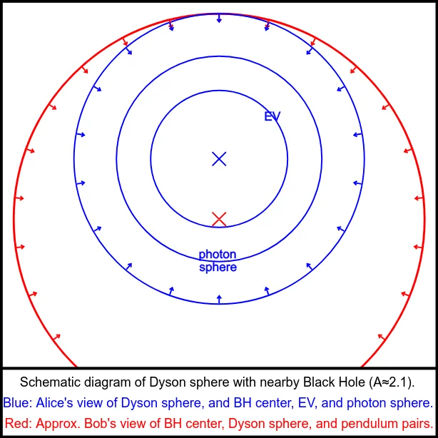

.Scott said:
If what you are saying is right, then I should be able to see that
If by "see" you mean purely by analyzing the light rays coming from the pendulums and looking at things like angles subtended in your visual field, I have no idea why you would think this. There is no guarantee whatever that an observer at a distance will be able to see, in this way, the same things that are being measured by local rulers.
Here's a schematic of the A=2.1 case.
The red is a rough estimate of what someone on the inner side of the Dyson sphere ("Bob") would draw based on what he sees outside his window. It is schematic, but the key feature is that because of the curved space time geometry, that inside surface would appear flatter that expected. If that is true, and those pendulums still appear to hang perpendicular to that inner Dyson surface (a conformal distortion as viewed by "Bob"), then the altimeter will compute a higher altitude for Bob.
That's exactly what I mean. And if the local guy is seeing different angles, he will be seeing different tidal effects. But does he see meaningfully different angles? That A=2.1 diagram I just posted shows my reasoning. But there may very well be holes in it.
As far as why I would think that, how else is he going to measure the local effect?
PeterDonis said:
However, there will be a light path that goes radially outward, reaches an altitude somwhat above the photon sphere, and then falls back down to the observer.
This cannot happen for a Schwarzschild black hole, because for a null geodesic ##\frac{d^2r}{d\lambda^2}=\frac{L^2}{r^4}\left(r-\frac 32r_S\right)##, which means that there are no maxima of ##r## on null paths at or above ##3r_S/2##. Light can only cross the photon sphere once, either inbound or outbound.
There are light paths just below the photon sphere that can do a lot of orbits (loosely speaking, because the required velocity for a circular orbit is only very slightly above ##c##), so you can see arbitrarily many of the pivots of the pendulums if you sit on the photon sphere. But light from the pendulum bob starts out below the photon sphere, so in order to reach you it needs to be on a trajectory that either grazes the photon sphere at your location or passes through it outwards. The optical effects will be weird.

.Scott said:
The second was to explain why my gravitational altimeter would be reading (or inferring from tidal effects) a much larger altitude than Alice.
It shouldn't be. The arc length between two points at equal altitude is ##r\int_{\phi_0}^{\phi_1}\ d\phi##, as you can read off the Schwarzschild metric. Your pendulum bobs have the same ##\phi## coordinates as their respective pivots, so the proper distance between the bobs is smaller because ##r## is smaller. Thus the ruler distance between the bobs is always less than the ruler distance between the pivots.
Working out exactly what you would get for something like radar distance between the bobs versus the pivots is fairly messy. You could approximate it with Rindler coordinates in flat spacetime, however, by considering your two pendulums to be placed at fixed ##y## coordinates and undergoing Rindler motion in the ##+x## direction. For simplicity consider the echo to happen at ##t=0## and compute the Rindler time between pulse emission and echo reception as a function of the proper acceleration of the Rindler observer. I strongly suspect this decreases monotonically as the proper acceleration increases - i.e., as you get closer to the horizon the radar distance between nearby bobs is always lower than that between their pivots.
How are you obtaining this? Based on what math?
What math are you basing this on?
No, he won't. There is only one spacetime geometry. If the local guy thinks he's seeing different tidal effects, it's because he's not doing the calculations correctly based on his observations, to correct for whatever optical effects the light he's seeing goes through on its way to him.
I told you how in post #10.
