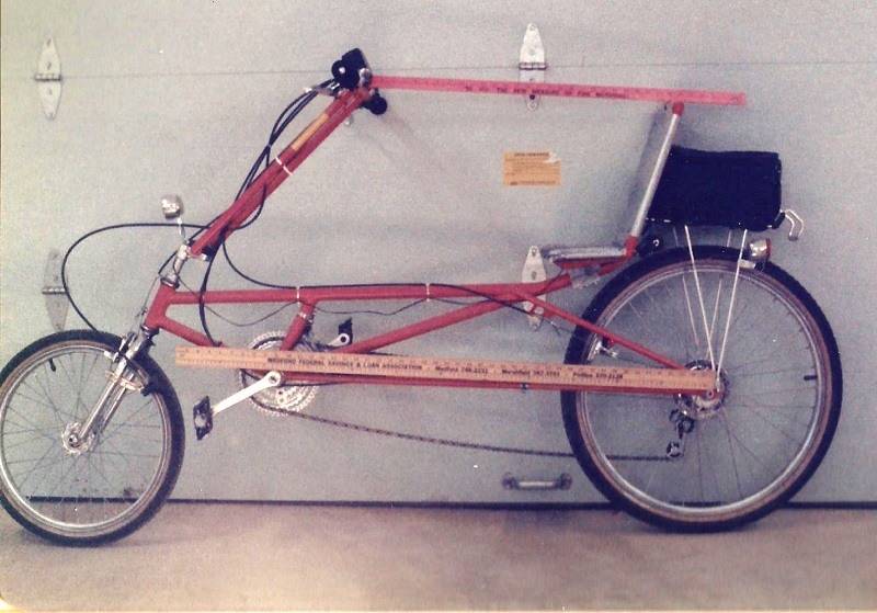

All of which is why the best frame material for most individual builders is good old 4130 Condition N aircraft tubing. It's readily available in many sizes and wall thicknesses, easily weldable, affordable, and has good fatigue resistance. That's because it was specifically designed for aircraft use, where the material requirements are virtually identical to the material requirements for motorcycle frames.
And that's why I built this CLWB bicycle frame from 4130 tubing. It survived a stress test that include riding down a flight of stairs, and over 3000 miles of riding. The frame was still good when I saw it about ten years after selling it.

Not really. I needed to stress test it before trusting it on bumpy city streets. The frame flexed enough to bounce the generator off the rear tire going down the steps. The generator is barely visible behind the seat back and above the rear tire. A little frame flex plus the 2.125" rear tire really helped the ride quality.
I liked the handling. If I entered a curve too fast, the rear tire would slide out, the bike would go down, and I (several times) ended up sitting on the side of the seat without a scratch or bruise.
