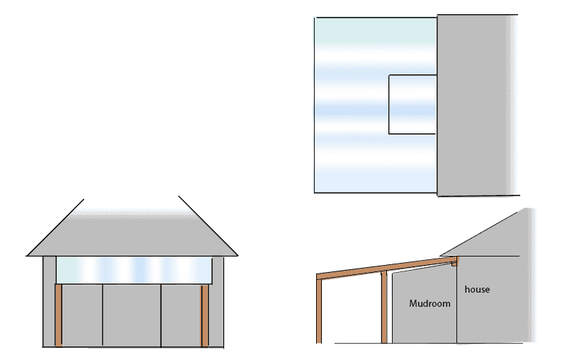

I'm looking to roof over my backyard deck. I have particular desires for it.
It must
- let in light
- be rainproof
- not reflect sound well
- be bug-unfriendly (more on this)
Most of the materials that are transparent and rainproof are also hard, and thus reflect sound efficiently, meaning it definitely sounds like you're under a roof. This defeats the purpose of being outdoors.
As for bug-unfriendly, it merely needs to be not impossible to clean.

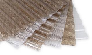

One thing I've thought of is to use Palram acrylic panels:
I've got them over my carport now. They're OK but very noisy.
I thought of hanging a layer of canvas panels to dampen the sound, but then they become bug magnets (got LOTS of spiders already, putting up a gap like this will fill with spiders until the roof is opaque!) So it's got to be arranged in a way that doesn't encourage webs, and also allows the webs to be cleaned.
Suggestions?

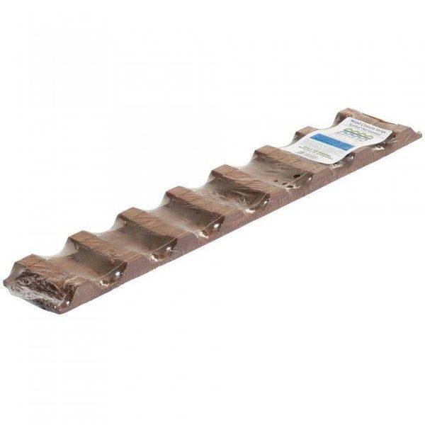

You should use the wavy wood strips (closure strips, in either wood or plastic) across the tops of the joists (and perp. to them) to nail the acrylic panels to.
Yes. I use them on my carport, to screw the panels into.

Possibly you could cover the underside with a layer of clear corrugated acrylic panel, but seal it off well.
The corrugated acrylic panel is the stuff that is noisy.

Your roof should be build using at least 2 x 4 joists on, say, 18" or 24" centers. I don't know where you live, but if it's an area that gets snow, the roof should be built strong enough to accommodate an appreciable snow load.
With the acrylic roofing on top, and plywood sheathing on the bottom, the sounds that annoy you shouldn't reflect as much from the plywood as they would from the acrylic roofing. Leaving one or more openings in the plywood is a compromise so that you can get some light through the roof without having the entire underside of the roof reflecting sound back to you.
My suggestion is similar to the light tubes that CWatters is suggesting, but without having to buy anything special. In any case, I'm not sure they make light tubes that are only 4" (the depth of a 2 x 4) long. Usually that are long enough to extend from the roof down through an attic to a room or hallway in a house.
Yeah. Snow load will be a problem. The slope will be very shallow.
It will be attached to the house only about 10 feet up, under my eaves. And the outer edge must be about 7 feet, so you can walk under it. So 3 foot drop over 16 foot run.
This is modeled very much like my carport, which is 22' long, 10' deep and 7-9' high. 24" on-centre (because the corrugated acrylic sheets are 24"). It's held up OK.
(It'll have more uprights, this is just a schematic.)
