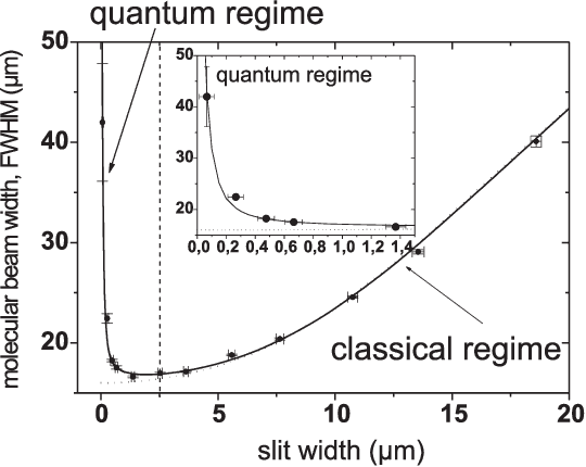

This is a tough question that i wanted to clear up for myself.
https://www.semanticscholar.org/pap...rndt/1b4ab0aead781f18765e5ed66cd4893b060dc2e2
The authors establish the 'cut' which is gradual from between 2 nm(about 20 atoms across) all the way up to 3-4 micrometers(30 000 atoms across) where classical mechanics is a more useful description(the test was done with C70 mollecules).
The processor industry has been dealing with quantum issues(tunneling, rough edges, etc) for at least a decade. But this is the practical side which agrees with the predictions established by the HUP.
My question regards the treatement of the world in a quantum mechanical fashion and extending and interpreting reality beyond the cut. I read threads where this was addressed briefly as a side-issue and most seem to agree Bohr was mistaken in assuming the double slit setup should be treated as 2 separate domains - the system as qunatum mechanical and the apparatus as classical.
At least from a practical point, such treatment should be quite valid and obvious given the graph and the scales where quantum effects start to become overwhelming. It could be that the current framework of quantum theory should not be taken as a literal explanation of macro reality, given the cut(whose nature still appears be unknown, though much research appears to be focused on mesoscopic scales 10 to 1000nm). To me it makes more sense to treat the apparatus as classical ala Bohr, esp. given the cut which was likely not experimentally known in the 1940's(though it was predicted theoretically even earlier).
They do no such thing.
First, the authors are being inconsistent. On the one hand, they label part of the chart as "classical regime"; but on the other hand, they claim that this experiment is a confirmation of the uncertainty principle. There is no uncertainty principle in classical physics, so in order to interpret the experiment as confirming the uncertainty principle, you have to interpret the entire regime using quantum mechanics. You can't arbitrarily label part of it as "classical".
Second, to establish a "cut" anywhere, the authors would have to show both of the following:
(1) That the part labeled "quantum regime" cannot be modeled correctly by classical physics. But this is wrong because classical diffraction theory predicts the same widening of the beam width for narrow enough slits that is observed. So this regime does not require quantum physics for its explanation.
(2) That the part labeled "classical regime" cannot be modeled correctly by quantum physics. But this is wrong because the predictions of quantum physics are pretty much the same as the predictions of classical physics in the part labeled "classical regime"; they have to be since quantum physics is well approximated by classical physics in this regime.
One would expect someone like Anton Zeilinger to know that classical diffraction can explain the sudden widening of the beam for narrowing slits.
The figure caption makes it clear what the authors want to express:
FIG. 3. The experimental molecular beam width (full circle) is compared with the quantum prediction (continuous line) as a function of the slit opening Δx. The agreement is excellent across the whole range of slit openings (70nm...20 μm). A purely classical shadow model predicts the dotted line and is in marked disagreement with the data for Δx < 4μm. The latter is therefore designated as the quantum regime and magnified in the inset of fig 3.
Which in itself means this experi`ment can't be evidence for a classical-quantum "cut", since the quantum prediction matches the experimental result over the entire experimental regime.

kith said:
There isn't a classical wave theory of matter.
If that's true, then the label "classical regime" on the graph is wrong, because there is no "classical regime". Which I agree with: classical physics predicts that "matter" as we know it should not exist--atoms should collapse. But then, as I've said, this paper is not evidence for a "classical-quantum cut", since there can't be any such thing if classical physics can't explain the existence of matter.
EPR said:
If figure 3 is correct, something as big as a virus will likely not be found in a coherent state.
What do you mean by "a coherent state"?
I think by "classical regime" they mean the regime were classical mechanics can be used as an approximation to explain the results while in the "quantum regime", QM is needed.
I agree that the labeling is a bit misleading and that this paper doesn't intend to show that there's a "regime" where QM is false and classical mechanics is true instead. The correct notion of a "cut" is the Heisenberg cut and this cut is shiftable and is present only in some interpretations.
This clears it up for me about the 'cut'. The classical regime should be labelled 'classical-like regime' as all systems at all scales are always in a superposition of states. It's an abuse of terms, as there is no classical theory of matter(or atoms would collapse).
