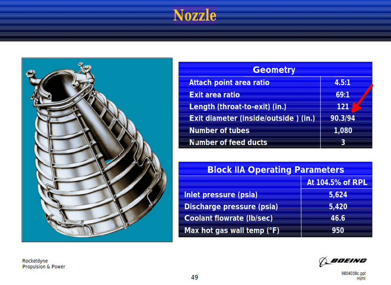

from: https://space.stackexchange.com/questions/43359/what-is-the-thickness-of-a-rocket-nozzle
At the exit plane the Space Shuttle Main Engine (SSME) nozzle was about 2 inches thick. This was a regeneratively cooled nozzle built up of tubing with a manifold encircling the exit.
enter image description here
Source: SSME Orientation (annotation mine)
(in case the above link doesn't work, here is where it points:
http://large.stanford.edu/courses/2011/ph240/nguyen1/docs/SSME_PRESENTATION.pdf)

I found these numbers, but they don't let you calculate a mass of the nozzle. It's not a 2 inch sheet, the thickness is caused by individual thicker parts at the end of the nozzle.
