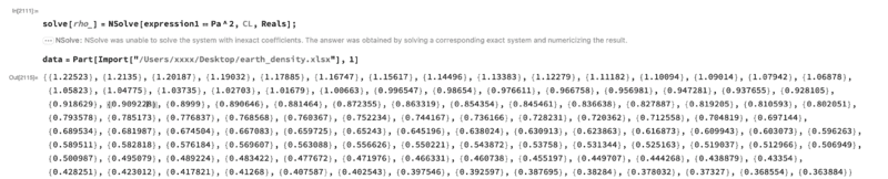

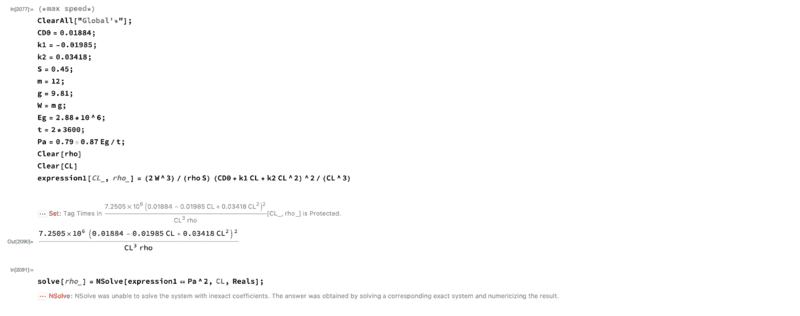

Hi. I am writing a program in Mathematica that reads a xsl file from excel, then processes it by solving an equation, and lastly turns the processed data into a list for exporting.
Context: Finding the maximum speed of a model plane at different altitudes (density).
Screenshots of the code and outputs (oh gosh the compression):
Screenshot of a Mathematica notebook cell defining constants CD0, k1, k2, S, m, g, W, Eg, t and Pa, then an expression for CL and rho, with an error message about the Set tag Times being protected.
^ Defining the parameters and the equation using a nested function; only real solutions are recorded.
Mathematica session showing an NSolve error message, followed by a long list of decimal values (1.22523, 1.2135, 1.20187...) output from importing the first column of earth_density.xlsx.
^ Data structure

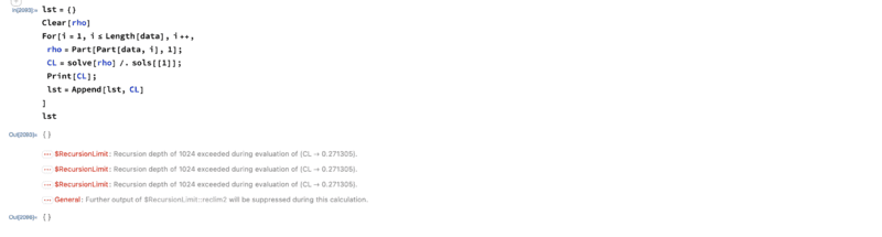

Mathematica notebook screenshot of a For loop that appends CL values to a list, followed by repeated $RecursionLimit warning messages reporting recursion depth 1024 exceeded during evaluation of CL → 0.271305.
^ For loop used to call the function and add the result into a list.
As you can see above, the for loop gives rise to several error messages. The solve nested function takes the density and outputs the CL (lift coefficient) value, which works fine in the code:

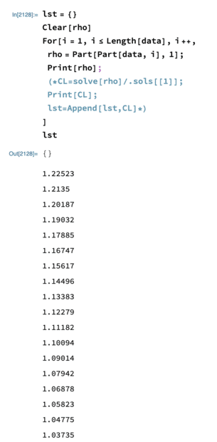

The compilation of rho also seems fine:
Mathematica notebook screenshot showing a For loop code cell with rho extracted from data, followed by a column of numeric output values from 1.22523 down to 1.03735.
Then the errors must have been caused by these lines in the for loop:
CL = solve[rho] /. sols[[1]];
Print[CL];
lst = Append[lst, CL]
Could someone please tell me how to fix this? Thanks in advance.

Your first error is caused by not having semicolons after Clear[rho] and Clear[CL]
  • Love
Dale said:
Please don’t screenshot code. Use the standard code delimiters like so:
[CODE lang="cpp" title="Example code block title"]//some code here [/CODE]
I have put my code into a proper code bloc; thanks. Putting semicolons after Clear[] does not solve the issue, unfortunately.
Not even the first one?: “During evaluation of In[2097]:= Set::write: Tag Times in ((7.2505*10^6 (0.01884 -0.01985 CL+0.03418 CL^2)^2)/(CL^3 rho))[CL_,rho_] is Protected.”
It looks like you have some old stuff in memory. Your code here doesn't even produce the first error. Try quitting your kernel and evaluating again.
Thanks a lot! It is working now!
