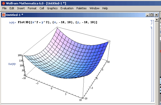

I picked up Mathematica 6.0 a couple days ago, so bear with me please.
1) Plot3D[{x^2 + y^2}, {x, -10, 10}, {y, -10, 10}]
returns a blank graph whereas when I set the boundaries from 0 to 2 it returns the actual graph! Why isn't it working?2) When typing equation f into the Plot3D function( e.g {x^2 + y^2} ), is it implied that x^2 + y^2 == z ? I would think so, but using == doesn't work in the Plot3D expression.
Plot3D[{x^2 + y^2}, {x, -10, 10}, {y, -10, 10}] returns the correct plot for me with no problem.
Yes, that is the implication for Plot3D, however it is not expressed as an equation since you cannot use Plot3D to plot e.g. a sphere using an equation like x^2 + y^2 + z^2 == 1. Instead, the first argument to Plot3D must be a function of the variables in the second and third arguments. This is also done for syntactical consistency with other plotting routines where a 3rd coordinate wouldn't make as much sense (e.g. density plots and contour plots)
Hmmm, perhaps my copy is broken.
