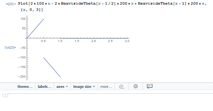

Hmmmm... Maybe I'm writing it wrong but this is what mathematica gives me for ##n=3## if ##U=100## and ##a=1##

Let for ##u < v## let ##I_{[u,v]}(x)## be the indicator function for the interval ##[u,v]##, defined as
[tex]I_{[u,v]}(x) = \begin{cases} 1, & \text{if} \; x \in [u,v] \\<br /> 0, & \text{if} \; x \not\in [u,v]<br /> \end{cases}[/tex]
Then (assuming that one of the troughs is at ##(0,0)##) your basic building block is ##f(x) =100\, |\,2x/a\,| \, I_{[-a/2,a/2]}(x)##. You can sum translations of that to get the whole function ##F(x)##:
[tex]F(x) = \sum_{n=-\infty}^{\infty} f(x - na)[/tex]
If you don't like the indicator function, but would rather use the Heaviside function, you can write it in two ways:
[tex](1)\; I_{[u,v]}(x) = H(x-u)H(v-x) \\<br /> (2)\; I_{[u,v]}(x) = H(x-u) - H(x-v)[/tex]
This should work.
T = (2*100)*x/a+sum from i=2 to i=10 of (2*(-1)^(i+1)*Heaviside(x-.5*i+.5)*(2*100)*(x-.5*i)/a-200*Heaviside(x-.5*i-.5)*(-1)^i) -200*Heaviside(x-.5)+200*Heaviside(x-1)

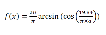

You can't do a Fourier Series for a sawtooth wave? It's periodic and there should be an example somewhere showing what the result is. You may only need either sines or cosines in the Fourier Series, depending on the time variable for the sawtooth wave.
try this function :
