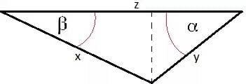

1. Find α(β) given that the sum of the 2 sides= ##(x+y)## and its third, ##z## is a constant for 0<β<180.
You can imagine that there's two pieces of string connected between two points. One string is as long as the distance between the two points while the other string is longer. If you stretch the longer string such that it will form a triangle like in the diagram, you'll notice that ##x, y## varies but their sum is a constant. The question is how would you find the angle of α given that you know what β, z and the sum of ##x+y## are.
2. My attempt.
Before we do it, let’s identify the third angle of the triangle, call it ##n## (in radians)##=\pi-\alpha-\beta=\pi-(\alpha+\beta)##. This will be useful later. We could just apply law of sine straightforwardly but nah. Let’s try and find it instead.
Let’s call the dashed line ##h##. So, ##\sin{\alpha}=\dfrac{h}{y}## and that ##\sin{\beta}=\dfrac{h}{x}##. Solve for ##h## in those two equations so we can get the law of sine. You’ll get the following : ##x\sin{\beta}=y\sin{\alpha}=h##. From this, divide across the equations by ##\sin{\beta}\sin{\alpha}## to get: ##\dfrac{x}{\sin{\alpha}}=\dfrac{y}{\sin{\beta}}=\dfrac{h}{\sin{\alpha}\sin{\beta}}##. You can invert those equations if you want, either way there’s the law of sine. We’d found ourselves a connection between the angle ##\alpha## and ##\beta##, but what about the third angle, ##n##? Let’s try it out, From the law of sine: ##\dfrac{z}{\sin{n}}=\dfrac{z}{\sin{(\pi-(\alpha+\beta))}}##. From symmetry of how the sine function works, that last equation is the same as: ##\dfrac{z}{\sin{(\alpha+\beta)}}##.
So far, we’ve found 4 equations that are equal to each other; a result from the law of sine:##\dfrac{x}{\sin{\alpha}}=\dfrac{y}{\sin{\beta}}=\dfrac{h}{\sin{\beta}\sin{\alpha}}=\dfrac{z}{\sin{(\alpha+\beta)}}##. This is good because we have this: ##\dfrac{h}{\sin{\beta}\sin{\alpha}}=\dfrac{z}{\sin{(\alpha+\beta)}}.## Now all we need to do is find what ##h## is and plug it in. After that, I can now solve for ##\alpha##. If you had figured out what ##x+y## is in terms of trig functions, sine function to be more specific, it’ll be: ##x=\dfrac{h}{\sin{\beta}},y=\dfrac{h}{\sin{\alpha}}##. If you add ##x+y##, it should give you ##x+y=c =\dfrac{h(\sin{\alpha}+\sin{\beta})}{\sin{\alpha}\sin{\beta}}##. We’d define ##x+y=c## so it can be less messy. Solve for ##h##, ##h=c\dfrac{\sin{\alpha}\sin{\beta}}{\sin{\alpha}+\sin{\beta}}##.Plug this into ##\dfrac{h}{\sin{\beta}\sin{\alpha}}=\dfrac{z}{\sin{(\alpha+\beta)}}## and you’ll get:## \dfrac{z}{\sin{(\alpha+\beta})}=\dfrac{c}{\sin{\alpha}+\sin{\beta}}##. We have gathered all the important variables into this one neat equation. Now to solve for ##\alpha## ….
Well this is where I'm stuck.

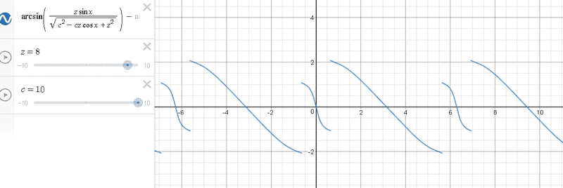

Assuming it's true, I tried graphing the solution which is ##\alpha(\beta)=\arcsin \left(\frac{z\sin {\beta}}{\sqrt{c^2-cz\cos \beta+z^2}}\right)-\arctan \left(\frac{c\sin \beta}{c\cos \beta-z}\right)##, where ##c>z## and this is what I got:
How does one interpret the solutions being negative in the ##(0, \pi)## interval?

Assuming it's true, I tried graphing the solution which is ##\alpha(\beta)=\arcsin \left(\frac{z\sin {\beta}}{\sqrt{c^2-cz\cos \beta+z^2}}\right)-\arctan \left(\frac{c\sin \beta}{c\cos \beta-z}\right)##, where ##c>z## and this is what I got:View attachment 204934
The solution for alpha can not be negative. The range of both the arcsin and arctan functions is (-pi/2, pi/2) Choose angle κ in the appropriate quarter, and alpha between 0 and pi.

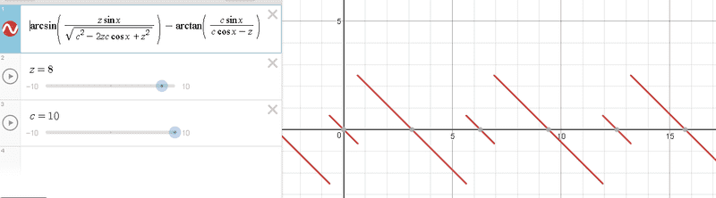

After taking some time thinking about the terms in the equation, I noticed that ##\arcsin \left(\frac{z\sin {\beta}}{\sqrt{c^2-2cz\cos \beta+z^2}}\right)## will always be ##(+)## for ##0<\beta<\pi## but for ##\arctan \left(\frac{c\sin \beta}{c\cos \beta-z}\right)## however, it can be ##(+)## or ##(-)## for ##0<\beta<\pi## which I'm having problem interpreting it because of the ##-z## term in the denominator of the argument.
Because of that ##-z## term, when ##0<\beta<\frac{\pi}{2}##, ##\arctan \left(\frac{c\sin \beta}{c\cos \beta-z}\right)## can be ##(+)## or ##(-)## because as ##\beta## → ##\frac{\pi}{2}##, ##c\cos \beta## becomes smaller and smaller and it'll eventually get overpowered by the ##-z## term. But for ##\frac{\pi}{2}<\beta<\pi## it's less complicated because it will always of the form of ##\arctan{(\frac{a}{-b})}##.
So my problem is how do I adjust ##\arctan \left(\frac{c\sin \beta}{c\cos \beta-z}\right)## for ##0<\beta<\pi## such that it doesn't make ##\alpha(\beta)## become negative?

Alright! It seems that I've figured it out thanks to you. So the solution should be a piecewise function:
##\alpha(\beta)=\begin{cases}
\arcsin \left(\frac{z\sin {\beta}}{\sqrt{c^2-2cz\cos \beta+z^2}}\right)-\arctan \left(\frac{c\sin \beta}{c\cos \beta-z}\right)+\pi & \text{ if } 0<\beta<\arccos{(\frac{z}{c})} \\
\arcsin \left(\frac{z\sin {\beta}}{\sqrt{c^2-2cz\cos \beta+z^2}}\right)-\arctan \left(\frac{c\sin \beta}{c\cos \beta-z}\right) & \text{ if } \arccos{(\frac{z}{c})}<\beta<\pi
\end{cases}##
The reason why it's defined as a piecewise function is because of the original solution which is: ##
\alpha(\beta)=\arcsin \left(\frac{z\sin {\beta}}{\sqrt{c^2-2cz\cos \beta+z^2}}\right)-\arctan \left(\frac{c\sin \beta}{c\cos \beta-z}\right)## is defined to be from ##(-)## to ##(+)## during the ##0<\beta<\frac{\pi}{2}## interval. I tried finding at what value of ##\beta## when ##\alpha(\beta)## starts to change from being ##(-)## to ##(+)##.
I noticed that the term: ##
\arctan \left(\frac{c\sin \beta}{c\cos \beta-z}\right)## can be undefined for a certain value of ##\beta## that makes the denominator equal to 0. Thus, setting ##{c\cos \beta-z}=0## to had enabled me to conclude that
\arctan \left(\frac{c\sin \beta}{c\cos \beta-z}\right)## is undefined when ##\beta=\arccos{(\frac{z}{c})}##. What's useful from this is that I can now determine at which interval does
\arctan \left(\frac{c\sin \beta}{c\cos \beta-z}\right)## starts to change its sign. I managed to construct a sign diagram and conclude that
\arctan \left(\frac{c\sin \beta}{c\cos \beta-z}\right)>0## in ##(0, \arccos{(\frac{z}{c}}))## interval and
\arctan \left(\frac{c\sin \beta}{c\cos \beta-z}\right)<0## in ##(\arccos{(\frac{z}{c}}), \pi)## interval. This allowed me to adjust ##\alpha(\beta)## better so I can prevent it from being ##(-)##.
Since ##\arcsin{m}=\theta\pm k\pi##, I can adjust the value of
\arctan \left(\frac{c\sin \beta}{c\cos \beta-z}\right)## in the ##(0, \arccos{(\frac{z}{c}}))## interval such that ##\alpha(\beta)## is not defined to be negative and that it manages to merge with the original function to make ##\alpha(\beta)## "continuous"(You could use calculus to figure out what value is ##\alpha(\beta)## when ##\beta=\arccos{(\frac{z}{c}})##). Here's the graph of it:

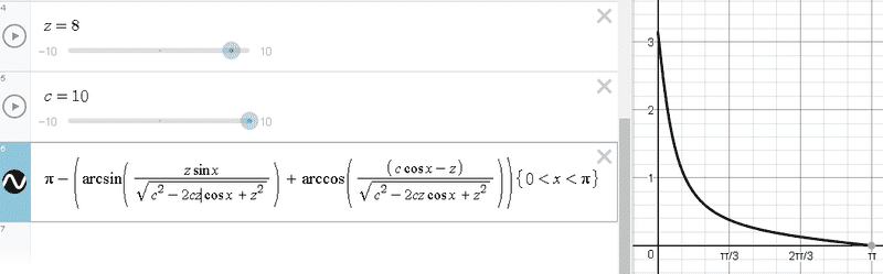

Oh no. I forgot that ##\alpha(\beta)## has to be defined for all values in ##(0, \pi)##. Which means the solution should be this:##
\lim_{\beta\rightarrow \arccos{(\frac{z}{c})}}\alpha(\beta) & \text{ if } \beta=\arccos{(\frac{z}{c})} \\
\end{cases}##
But how do I determine the limit of ##\alpha(\beta)## as ##\beta \rightarrow \arccos{(\frac{z}{c})}##?

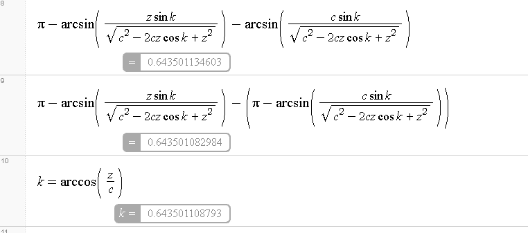

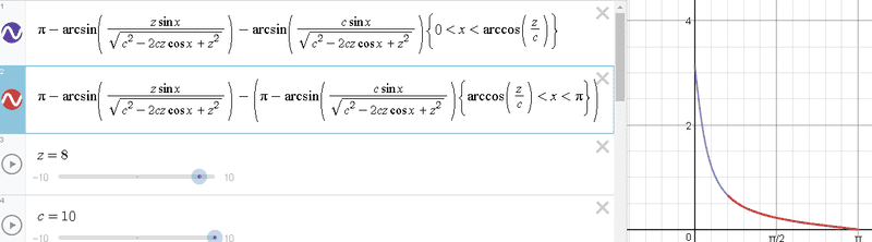

With ##\arcsin##:
\pi -\arcsin \left(\frac{z\sin \beta}{\sqrt{c^2-2cz\cos \beta+z^2}}\right)-\arcsin \left(\frac{c\sin \beta}{\sqrt{c^2-2cz\cos \beta+z^2}}\right) & \text{ if } 0<\beta<\arccos{(\frac{z}{c})} \\
\lim_{\beta\to\arccos{(\frac{z}{c})}}\alpha(\beta) & \text{ if } \beta=\arccos{(\frac{z}{c})} \\
\pi -\arcsin \left(\frac{z\sin \beta}{\sqrt{c^2-2cz\cos \beta+z^2}}\right)-\left(\pi -\arcsin \left(\frac{c\sin \beta}{\sqrt{c^2-2cz\cos \beta+z^2}}\right)\right) & \text{ if } \arccos{(\frac{z}{c})}<\beta<\pi
\end{cases}##
It's graph:
Which is the same as ehild and Ray's solution except that I left one point not included because:
The values of these two separate functions are not equal to each other when I set ##\beta=\arccos{(\frac{z}{c})}## but from the graph it seems to approach to some finite value so I'd defined it as the limit of ##\alpha(\beta)## as ##\beta \to \arccos{(\frac{z}{c})}##. I think it's approaching ##\arccos{(\frac{z}{c})}##.

Here is a not-piecewise function for alpha(beta) :
I used the addition law for cosine:
##\cos(\alpha-\theta)=\cos(\alpha)*\cos(\theta)+\sin(\alpha)\sin(\theta)##
with
##C\sin(\theta)=A\cos(\theta) ## and ##C\sin(\beta)-z=A\sin(\theta)##
##A=\sqrt{C^2-z^2-2Cz \cos(\beta)}##
##\alpha-\theta=\arccos(\frac{z}{A}\sin(\beta))##
##\theta=\arctan\left(\frac{\cos(\beta)-z/C}{\sin(\beta)}\right)##
So
##\alpha=\arccos(\frac{z}{A}\sin(\beta))+\arctan\left(\frac{\cos(\beta)-z/C}{\sin(\beta)}\right)##
