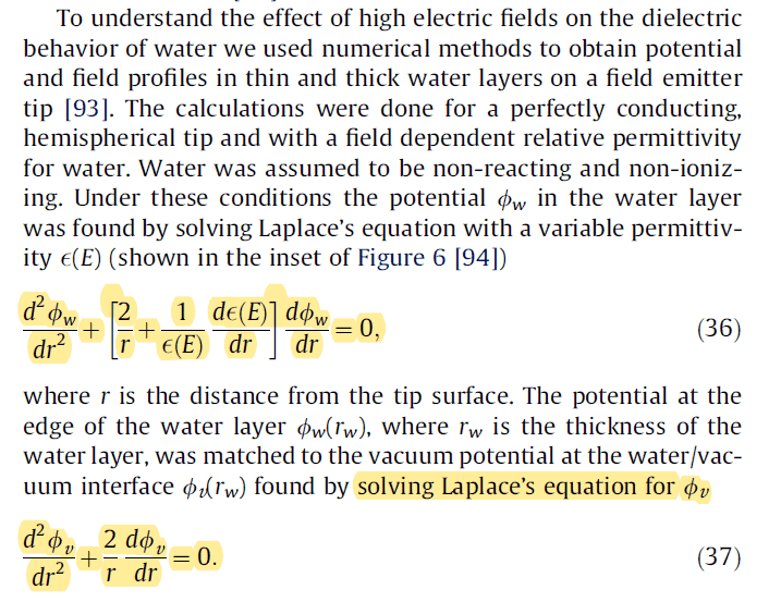

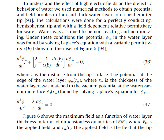

I recently read a paper on using an electric field to drive water autoionizaton. I'm trying to figure out how to use the Laplace equation on pg 9; 4th paragraph; to solve for voltage. I'm also interested in how this equation would change if I replaced the hemispherical tip with a parallel plate. Anyone strongly familiar with this subject matter? Any help is greatly appreciated!

I haven’t run through the math specifically, but it’ll be the Poisson equation no matter what, but the boundary conditions will change. So for parallel plates, you’ll want to look at the Laplacian in Cartesian coordinates instead of spherical coordinates as your starting point.

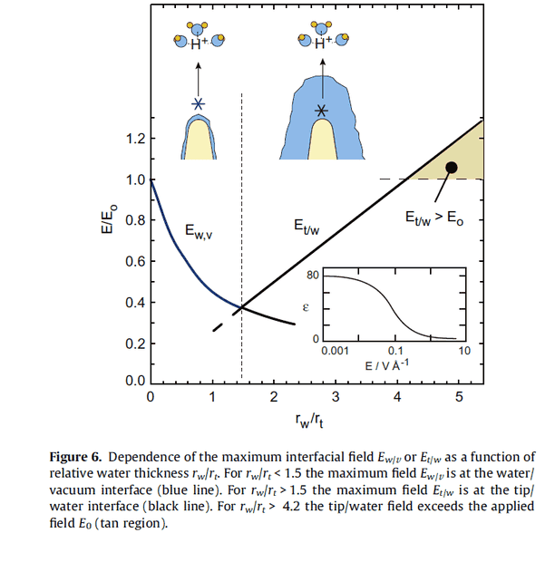

Thank you for the response! I still have some questions about the variables. I know how to use Figure 6 to find the values for maximum interfacial field Ew/v or Et/w and water thickness rw/rt, but I'm still not sure what to do with (E), d, or how to solve for ϕw or ϕv.

It’s unclear how much background knowledge you have and if this problem is at the right level for you. For instance, I don’t see a ##d## being used as a variable in any of these images. The only ##d##’s I see denote derivatives.
To get the potential (aka the voltage), you would solve the Poisson/Laplace equation for ##\phi##, given the appropriate boundary conditions. I doubt there’s an analytical way to do it without a really simple functional form for ##\epsilon(E)##, but it should be possible to write a code to get a numerical solution. To get the electric field, you take the gradient of the potential (assuming the system is time-invariant).
