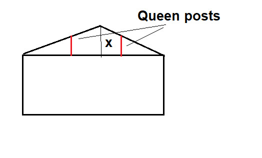

The front face of a house is in the shape of a rectangle with a Queen post roof truss above. The length of the rectangular region is 3 times the height of the truss. The height of the rectangle is 2 ft more than the height of the truss. If the total area of the front of the house is 336 ft^2 determine the length and the width of the rectangular region
Area for rectangle: A = LW
Area for a triangle (1/2)bh
So the top of the structure is a triangle with height x. and the height of the rectangle is 2 + x, and the length is 3x.
I'm unsure where to go from here. I tried using the formula and getting 3x^2 + 6x +x = 3x^2 + 7x -336 =0 I applied the quadratic formula but it gave me non-integer solutions. I may be reading the problem wrong or not getting the right equation from the prompt.

The business of "Queen post roof truss" is a red herring. The only thing important about the truss is its height, which we can call x. The height of the Queen posts (I had to look up "queen post truss") is irrelevant in this problem.
The equation in the OP does not represent the sum of the rectangular area and the area of the roof truss.
"If the total area of the front of the house is 336 ft^2..."
In my formulation of the problem, there are two integer solutions, one of which is negative.

Can I get a hint at formulating the problem?
Look at the drawing I posted. In my drawing, x is the height of the truss. what are the dimensions of the rectangular part of the front of the house.
Again, the problem statement says this: "the total area of the front of the house is 336 ft^2..."
The front of the house includes the rectangular part and the area defined by the truss.
The dimensions are 3x(x +2) and the truss is 2 triangles so its x(3x) so its 3x^2 + 3x^2 +6x = 336
Write in standard form and get 6x^2 +6x - 336 = 0 The quadratic formula gets me x = 7, and x = -8

You're not very clear regarding the base and height for the triangles.
Start with an individual triangle. What is the expression for the base? What is the expression for the height?
The width of each triangle being...?
(1/2)x(1.5x) So I get 2(1/2)x(1.5x) so adding the area of the rectangle I get 3x^2 + 6x + 1.5x for a total of
4.5x^2 +6x - 336 = 0. The quadratic formula gets me 8, and - 28/3. The area of each triangle is (1/2)8 x 12 which is 48. The area of each triangle is 48 ft^2 both combined is 96 ft^2 and 96 ft^2 + 240 ft^2 = 336 ft ^2 so the answer checks.

That's what I get, x = 8. (I didn't bother simplifying the negative solution.)
Small typo in your quadratic equation -- should be ##4.5x^2 + 6x - 336 = 0##.
