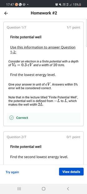

Consider an electron in a finite potential with a depth of V0=0.3eV and a width of 10nm.
i) Find the lowest energy level?
ii) Find the second lowest energy level?
Give your answer in unit of eV. Answers within 5% error will be considered correct.

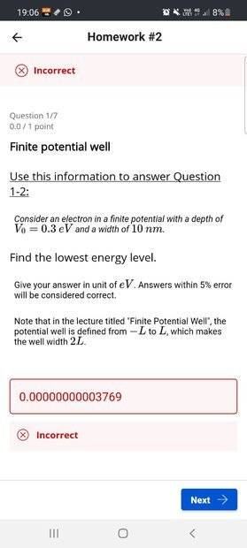

Note that in the lecture titled "Finite Potential Well", the potential well is defined from −L to L, which makes the well width 2L. Plz help solve this homework problem. The answer of 0.03769*10^(-9) mev is incorrect. I have also attached the screenshot

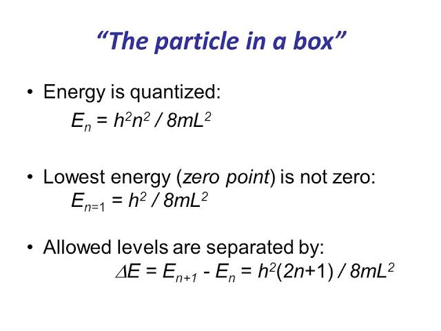

E(n) = n^2*h^2/(8mL^2)

Note that in the lecture titled "Finite Potential Well", the potential well is defined from −L to L, which makes the well width 2L. Plz help solve this homework problem. The answer of 0.03769*10^(-9) mev is incorrect. I have also attached the screenshot of incorrect message by autograder.
I do not understand where I went wrong? Formula is correct? It's application is correct and the answer I got in joule I converted to mev by dividing it by 1.6*10^-19 as you can clearly see in my work? Then how come autograder reject the answer?

It seems you are using the formula for the ground state of an infinite potential well to calculate the ground state of a finite potential well. If you review your notes you should see that there is a numerical technique to calculate the ground state when the well is finite. This is why they allowed a 5% variance in the answer I believe.

Sorry, I do not see the link to your notes but the formula you are using is valid for potential wells of infinite depth not finite depth like 0.3eV. I am not sure how your teacher presented this material but here are some notes I found;

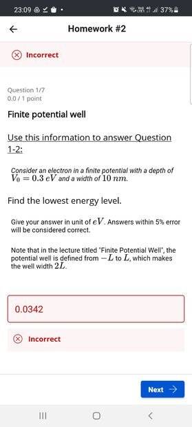

Searching on the net I found some material on finite potential well from Purdue University and there they solve the same problem of the width 10nm and Vo=0.3 eV using a MATLAB program. I entered those answers but they got rejected by the autograder. How is this possible?

It is possible that you made a mistake somewhere. We cannot tell you where you made a mistake merely by looking at the answer you found. You need to show us the details of your calculation. If it's a MATLAB program that you found on the web and just used, (a) how do you know you can trust it and (b) how do you know you used it correctly?

Another thing to check is your units and conversions in your calculations. Your ground state value is roughly ten times larger than what it should be given the depth and width of the well.

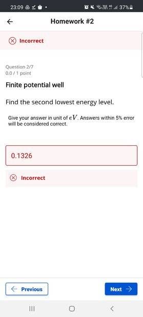

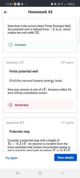

I got two values of eta
Eta 1=1.466 from which ground state energy was 0.00325 which was correct according to the autograder.
Eta 2 = 4.395 from which second energy was 0.02922, for some reason autograder rejected it. How is it possible for the same method one correct and another incorrect answer?

Thanks guys, I've finally solved the question, to find eta value for second energy we had to find intersection of curve with cot(eta) function since it has odd parity and hence find the energy. I've got the correct result for second part of the question as well.
