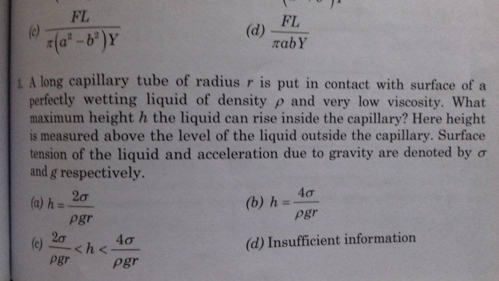

A capillay tube is just in contact with a liquid surface of perfectly wetting liquid. What is the maximum height liquid can rise inside the capilary?
H=2σcos(θ)/(ρgr)
I know that the height in general is goven by 2σcos(θ)/(ρgr). So the maximum height can be 2σ/(ρgr) with cos(θ)=1. But the answer given is c.
That is for the case where the surrounding reservoir is effectively infinite in area. How do you think it might be affected by a narrower surround?
(But I am not sure this gets to answer c.)
Thank you for you response. Actually the problem needs a dynamic treatment of the liquid in motion
Ah, ok... you unintentionally altered the statement by writing "is just in contact" instead of "is put in contact".
Does this mean you now get the intended answer?
