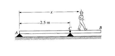

The uniform object AB mesures 4 meters and weighs 500N.
There is a fixed point C along which the object can rotate. The object rests on point A. A person of mass 75 kg walks over the object, starting in A.
40.1 Calculate the maximum distance x the person can walk keeping the object in equilibrium

Your image is not showing up, can you attach a file or otherwise explain the location of the supports A and C, the distance between A and C, and between C and the end of the object?
sure. I've attached it to this post

OK, I got your picture now. When you sum torques and set their sum equal to zero for the equilibrum condition, you can choose any point about which to sum torques, but you must use the same point when detremining the torques from each force. HINT: choose point C as the point about which to sum torques, and note that the weight of the beam acts at its center of gravity, and that the reaction force at A will be zero when the object just starts to tip, because the beam will start to lift off of support A as it starts to tip..
i think i considered C as the point of reference for Torque
(could you please point out where I didnt?).
And why do I need the center of gravity? should I consider it to weight differently in positions other than the center of gravity?
Thanks
Thanks
First, the resultant force of the beam weight, 500 N, acts at the center of gravity of the object, which since it's 4 m long, is located 2 m from A, or 0.5 m from C . When you sum torques of that beam weight about C, what's the torque? Your torque equation for the torque from the person about C is correct, so set them equal to solve for x.

Since the problem is asking you to find the farthest distance the peson can walk before the beam goes from its equilibrium stage to 'tipping over', this occurs when the end reaction at A is 0 (the beam lifts off that point at the start of rotation). So forget any torque from A, just sum moments about C ffrom the beam weight (500 times 0.5, ccw), and the persons weight (75g times (x-2.5), clockwise), set their algebraic sum equal to 0 for equilibrium (one is a plus, the other a minus value), and solve for x. (Note there is also no torque from the reaction force at C about C, since there is no moment arm)
it's correct, thanks.
so there's no need for torque at B or A?
oh, i see. The torque must be calculated only when forces are applied (center of gravity and the person).
There is no forces applied elsewhere so, no torque.
