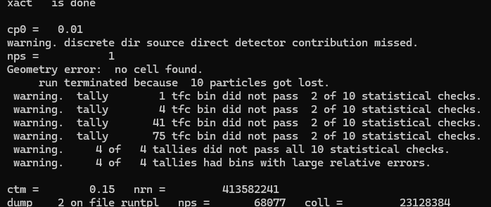

i am using MCNP6 and i am facing this problem from days and i can not found solution if anyone help me than i am ever grateful to you
files are attached
Thanks
  • Text output from an MCNP6 run, reading: warning. discrete dir source direct detector contribution missed; Geometry error: no cell found; run terminated because 10 particles got lost; four tallies fail 2 of 10 statistical checks; 4 of 4 tallies had bins with large relative errors.

Hello @ameermukhtar,
Welcome to PhysicsForums. Your bounding sphere defines the experiment area, and anything outside it is part of the void. That works so long as no objects poke through. If you run "mcnp ip inp=filename", the default view seems fine. But click on the input box and type "pz 149", to check close to corners of 9 and 10, you can see the corners of 9 (rpp) sticking through it. Just try making the sphere bigger and see if that fixes the problem.
thank you dear the problem has been solved
