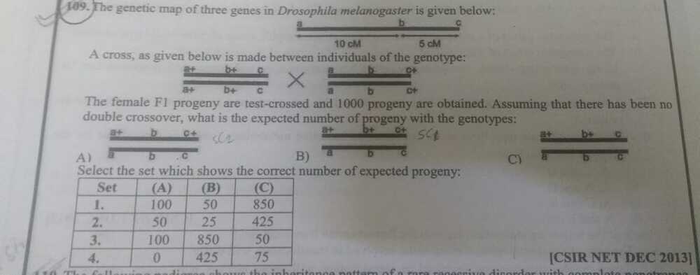

The given answer to this question is (2)
NA
Here (A) is a product of recombination between a-&-b, (B) is a product of recombination between b-&-c and (C) a parent
1. If 1000 is the total number of progenies, then 10% of it is 100 (A), 5% is 50 (B) and the rest should be <850 because the other parent has not been included. So I reject 1.
2. Here the total is 500, maybe they have considered the other P to be 500.
3. Not possible because for the given total (B) cannot be more than 50.
4. Similarly, it cannot be 425 either.
So I have to go back to 2. if we take to total population as 500, it is correct, but the total pop is not 500?!
I'm very confused about the concept, please guide me. Also, tell me if there's a simpler or shorter way to arrive at the correct answer.

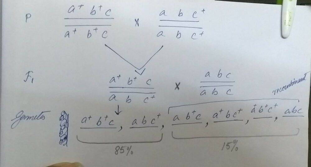

But doesn't the ratio 1:1 hold true for independently assorting gene combinations/genotypes? For linked genes, recombinant genotypes are rare and the parental ones are frequent.

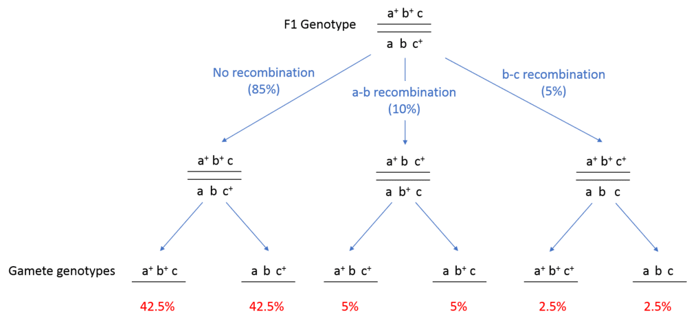

Try drawing out the possible gametes that can be produced by the F1 individual and assigning probabilities to each of the six possible gamete genotypes.
You've correctly listed out the possible gametes. Now, for each individual gamete's genotype (e.g. a+/b+/c), what is the probability?

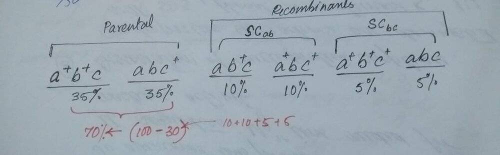

The math here disagrees with the math above. In your previous post, you correctly said that the two parental genotypes sum to 85%, but here your two parental genotypes sum to 70%.
I agree, my recent calculation contradicts the previous one. I think 70% makes more sense. Because in the question though they have provided only one genotype from each crossover type, the chances of occurrence of both the genotypes should be equal, P(a/b+/c)=P(a+/b/c+)=10%.
Ygggdrasil said:
Here's how I approach the problem:
Okay, I got this.
So the gametes arising out of non-recombination and recombination have the same chances of occurrence as its counterpart. The sum of the frequencies of a pair of recombinant gametes is the distance between them in map units.
Thank you. Thank you so much.
