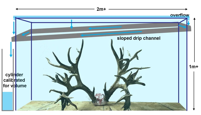

My idea is that I want to use immerse Whitetail Antlers in a fishtank to measure their volumetric displacement (the Boone and Crockett system is the current record measurement standard to place in a juxtaposition with) I would use some sight glass plumbed into the side of the tank to get the change in height so that I can multiply by the tank cross-section. Simple Idea. But...
Is there a simple mechanical way to amplify the height in the sight glass to increase measurement precision? Nothing is jumping out at me.

Fill the tank up to an overflow point, then immerse the antler with the overflow from the tank being directed to a narrow graduated cylinder. Would that work?
Thank you, that technique would make precision adjustable. Also, this measures the volume directly; skipping a computation step and minimizes propagated error.

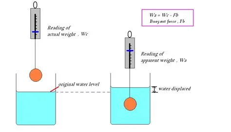

If you weigh them submerged as well as in air with a good electronic scale you could get a precise volume. You'd have to make a jig to do that but it isn't particularly difficult.
Do antlers sink? You might need to add a weight. Will they absorb a significant amount of water? That could throw things off as well. Another possible option is a DIY gas pyncnometer.

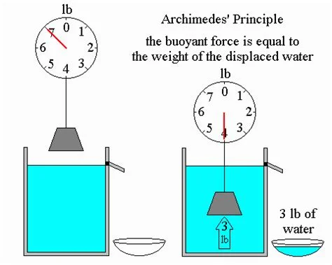

To determine the volume. The weight of a submerged object is equal its unsubmerged weight minus the weight of the water displaced.

You mean the water? Because weighing the object can be more precise than weighing the water that manages to slop over the edge or down a tube or whatever. I think more so the smaller the object but I would expect it would be true with deer antlers. But it isn't clear how accurate the OP wants it to be. Which is why I was curious what the point was for knowing the volume/density in the first place.

I sense that you are still missing what I thought was a very simple point. The weight of the antlers isn't of interest per se. But if you weigh the antlers both submerged and not submerged you can calculate the volume.

Until now, I had an image of a moderate fish tank doing the trick. But after putting a few numbers to it, I see I was off by an order-of-magnitude.
Maybe at this scale, it's not that hard to collect the run-off from a tank that big. Let it run off all around. Build a drip channel all around the lip that runs into a graduated cylinder. Use a squeegee to wipe down the bit of tank wall and the drip channel.
Heck, you could even mechanize the act of holding it underwater (so that an operator can't be accused of "putting his finger on the scale", so to speak). A lid (open or gridded) would ensure no points of the antlers stuck above the water.

It has to submerge completely. You can't be pushing it down it with your finger. You don't weigh the whole tank, just the submerged antlers. That weight will be equal to their normal weight minus the buoyant force, the latter being equal to the weight of the water displaced. Since you know the density of the water (by measuring the temperature) you can calculate the volume.
Actually the "normal" weight also includes a buoyant force due to the air. Scales are usually calibrated with metal weights (e.g. steel) that have a density around 8 g/cm3. In some cases this is the largest source of error in a weight measurement. For example, if you weighed a liter of 4°C water in air on a well calibrated scale you'd measure something close to 999g instead of 1000g.
The point is that you can be very precise once you deal with certain issues.
I'll have to take your word for it. I have no idea how your setup looks. I don't know you weigh a submerged object unless your whole scale is stainless steel.
OK, a few questions for @erobz:
  1. How do you see this utilized? For your own personal use, or is this open to all - say, at a public contest? This helps us understand practical constraints, such as: will need it to be
    - robust,
    - foolproof,
    - operable by a third party,
    - portable,
    as opposed to, say, you in your basement.
  2. Is the idea to (someday) replace - or at least offer an alternative to - the existing system?
  3. What are the maximum plausible dimensions of the best rack? All three dims, if you please. Moose antlers can span 2m in two dimensions. This will inform questions 1 and 2. I suspect a portable setup will require a pickup truck.
  4. Do all antlers float? Do all antlers sink? It sounds like, for this to be a practical alternative, the measurement proceure will have to accommodate both scenarios. Ideally, for fairness, it should use the exact same setup for both floaters and sinkers*.
* I imagine that might not be too hard. You can attach a standard weight to them, until they sink, then simply subtract that away.
DaveC426913 said:
I have no idea how one would do that.
I guess, unless you are assuming they are negaatively buoyant, and then I guess you would put the weigh scale in the tank?
No idea. and I think I'll stop guessing.
$$F_b = W_{act} - W_{app}$$
$$F_b = \rho_{fluid}gV_{fluid}$$
And if the object is completely submerged:
$$V_{obj} = V_{fluid}$$
Thus:
$$V_{obj} = \frac{W_{act} - W_{app}}{\rho_{fluid}g}$$
