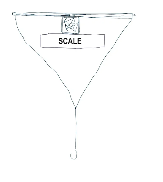

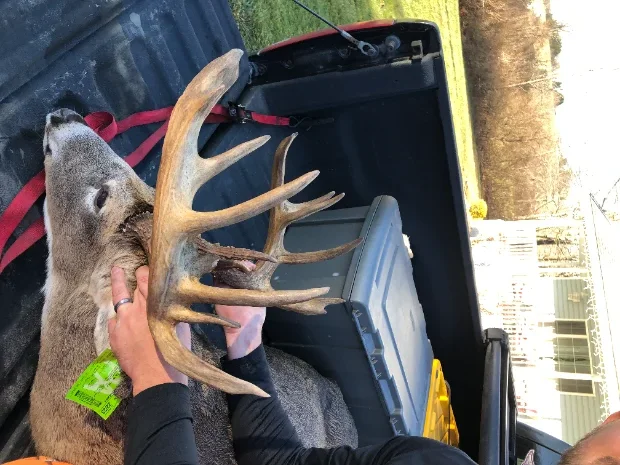

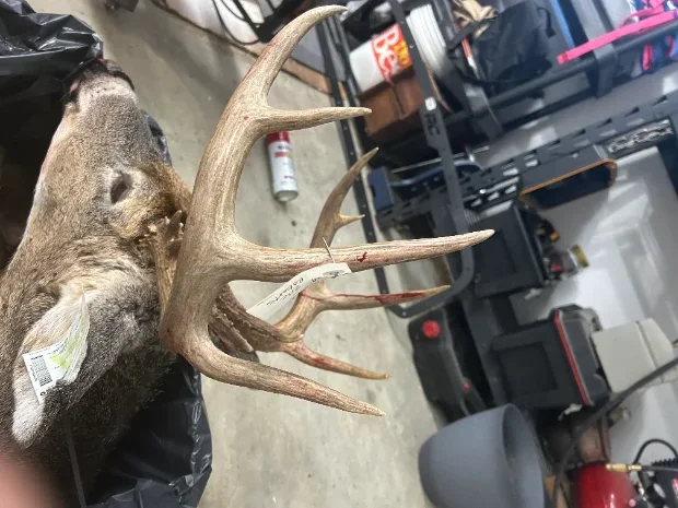

  • #31
Oh. A suspended spring scale. I am such a stupidhead. :sorry:
  • #32
Thanks, Jack.
Some expensive balances are designed with the ability to do this. I've used a small digital scale. I built a jig that allowed me to suspend an object below the scale on thin fishing line. It wasn't difficult to do. It looked sort of like this (you'll have to imagine how the scale is supported):
If the object isn't dense enough to sink well on its own then you'd need to add a dense weight.
This idea is used to estimate body fat percentage. You are weighed in air and then submerged in a tank, sitting on a seat attached to a scale. I did this once as part of a class. It was kind of fun.
But for antlers it's probably not worth the trouble. The guys in that paper I linked above used the overflow method.

  • #46
erobz said:
I wasn't really thinking about weight(although it could be argued to be just as genetically of interest)
The difference between the weight in air, and weight submerged in water, is the buoyancy, which is due only to the volume of the antlers. For freshwater, that is; 1 cc volume per 1g weight difference, or 1 litre per kg.
Procedure.
Attach the antler to the digital scales with a rigid wire, suspended from the scales. Weigh the antlers in air.
Then lower them into a lake, or your bath, not touching the bottom or sides, weighing them submerged, up to a fixed mark on the wire.
Subtract the weight submerged from the weight in air.
You then have both the weight and the volume of the antlers, in two weighings, without a need to weigh or to transport a tank.
