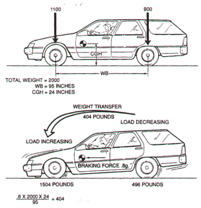

Let's say that we tell you that roughly a 45° angle is caused by 1 g of deceleration.
How are you going to relate that g-force that is acting parallel to the road, the position of the engine, the pitch (nose down) moment of the chassis, and the forces acting on each contact patch, during breaking?
Please, note that the "weight transfer" (from the weight on each tire measured in static conditions) has more to do with the CG height to wheelbase length ratio than with the longitudinal location of the engine (that is only important for oversteering and understeering problems).
You can ask "everyone (who) keeps saying that the rear brakes do most of the stopping" to go check and compare the diameters of the rear and front brake discs or drums.
The manufacturer should know better than that person which tire can handle more brake power before skidding.

Additionally, there is no such thing as "weight transfer". To the tires, it may seem there is additional weight under braking. In fact you can only transfer weight by physically placing lead weight bars to that corner of the car.
What you are dealing with is MOMENTUM and INERTIA. Get the problem identified and you can solve it.
Regarding post # 10 and note the wrong answer on the equation. It assumes the Center of Gravity is at the same height in before braking and during braking. This is obviously NOT the case as the front suspension will dive , compressing the front springs during braking and thus LOWERING the CG height and this throws off this equation. Using corrected CG height of 22 inches yields total value of the equation to 370 " pounds" if you MUST use weight transfer. You will need (simplistic answer not using motion rate spring rate and wheel rates) stiffer anti roll bar and front springs having 123 # more "spring rate " to counter the momentum. This is why ALL vehicles, ft engine , rear engine, mid engine need larger front brakes. It is not the weight, it is the momentum and inertia.
It is not obvious how much the front end will dive or that it will dive at all. Even so, It is not obvious that the CG will drop as well, as the rear end may go up. The suspension geometry will dictate that (anti-dive / anti-lift).

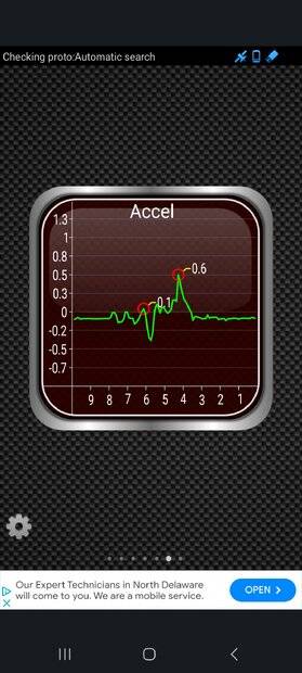

Vanadium 50 said:
There is also an app called "Torque" which can read your engine's parameters via OBD-II and record them, allowing you to cross-correlate with things like acceleration.
Phone sensors too: it does acceleration graphing. No OBD adapter needed...or car, for that matter:
I have phyphox on my Android phone. Someone posted here on PF about it recently. By which I mean in the last 2 or 3 years, lol.

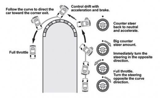

If I understand the maneuver properly, the driver still steers, controlling the trajectory of the drifting.
Copied from:
https://en.wikipedia.org/wiki/Drifting_(motorsport)
"Drifting is a driving technique where the driver intentionally oversteers, with loss of traction, while maintaining control and driving the car through the entirety of a corner or a turn. The technique causes the rear slip angle to exceed the front slip angle to such an extent that often the front wheels are pointing in the opposite direction to the turn (e.g. car is turning left, wheels are pointed right or vice versa, also known as opposite lock or counter-steering)."

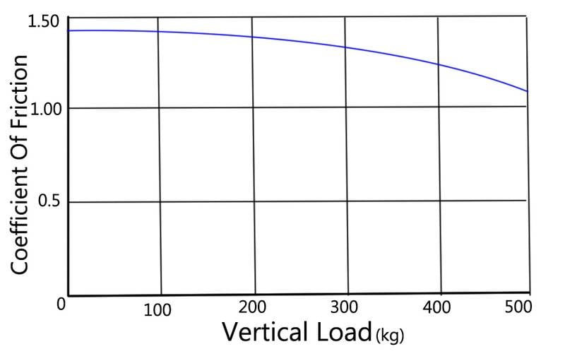

Porsche 911s are still rear engine because the weight distribution is more even under braking. Ultimately, the weak link in breaking is tire traction. Any manufacturer can easily make brakes that will lock the wheels, so that is not critical. But then tires skid or activating the ABS. Therefore, the key to the best braking is to get the best tire traction. That leads to the conclusion that the static weight distribution should be rear-loaded.
https://www.roadandtrack.com/car-culture/car-design/a17043585/why-the-porsche-911-is-rear-engined/
The reason why we prefer 25/25/25/25 loading on tires is that the friction force is not linear with the normal load:
http://technicalf1explained.blogspot.com/2012/10/f1-tirespart-2.html said:
A tire’s coefficient of friction decreases as load increases. However, this does not mean that traction decreases. Traction will increase with an increasing vertical load.
This effect is illustrated in the graph below:
The end effect is that the increase in friction force with a lower vertical load never compensates for the decrease in the more loaded tire(s). Therefore, anything varying from 25/25/25/25 will reduce the overall maximum friction force available.

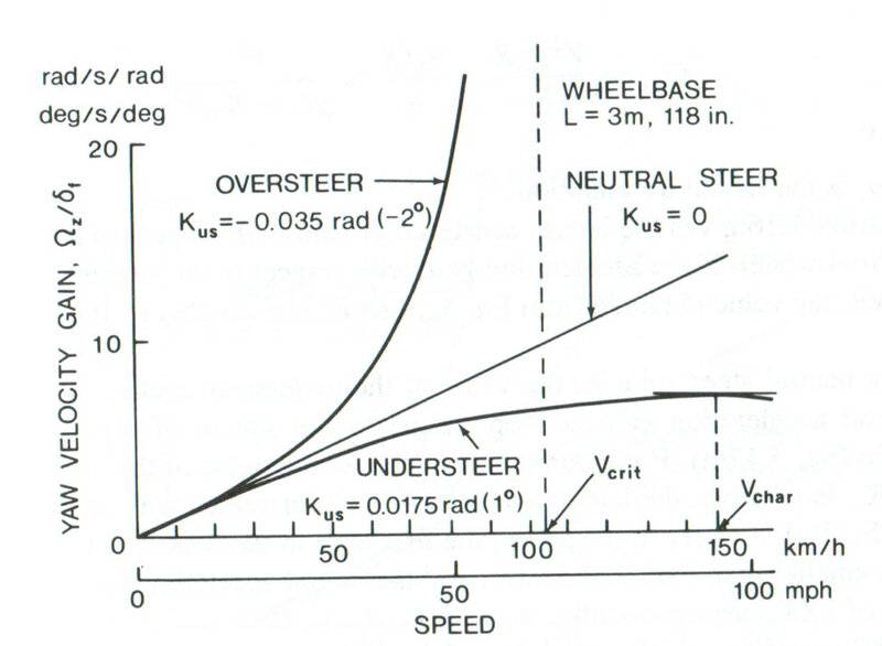

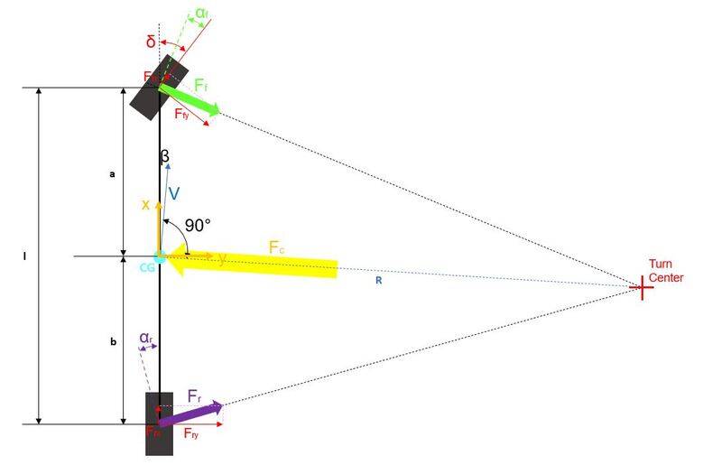

If you imagine the bicycle model:
The steering angle ##\delta## can be related to the slip angle of the tires:
$$\delta = \frac{l}{R} + \alpha_f - \alpha_r$$
The lateral tire forces ##F_y## can be expressed as a function of the slip angle:
$$F_y = C_{\alpha} \alpha$$
where ##C_{\alpha}## is the cornering stiffness of the tires. It can also be related to the mass and lateral acceleration:
$$F_y = \frac{W}{g}\frac{V^2}{R}$$
Leading to:
$$\alpha_f = \frac{W_f}{C_{\alpha_f}}\frac{V^2}{gR}$$
$$\alpha_r = \frac{W_r}{C_{\alpha_r}}\frac{V^2}{gR}$$
Where ##W_f## and ##W_r## are the front and rear weights. We thus end up with:
$$\delta = \frac{l}{R} + \left(\frac{W_f}{C_{\alpha_f}} -\frac{W_r}{C_{\alpha_r}}\right) \frac{V^2}{gR}$$
$$\delta = \frac{l}{R} + K_{us} \frac{V^2}{gR}$$
Where ##K_{us}## is referred to as the understeer coefficient for the vehicle.
With a neutral steer, ##K_{us}= 0##, and thus ##\delta = \frac{l}{R}##
With an oversteer condition, ##K_{us} \lt 0##. With this condition, a critical speed can be identified. It is the speed at which the steering angle required to negotiate any turn is zero:
$$V_{crit} = \sqrt{\frac{gl}{-K_{us}}}$$
Above this speed the vehicle's response becomes unstable. You can look for "snap oversteer" to find examples of it:
With understeer, you just need to stop what you were doing (braking or accelerating) to regain control of the steering; with oversteer, you usually need a diaper.

Now I know Jack gets it because he knew immediately about the fallacy of "weight transfer" He has heard me rant for years about this. One thing no one else (sophie came real close) picked up is the result of braking. You are loading the front tires by adding down force, thus traction. More traction, more grip, faster stopping.
