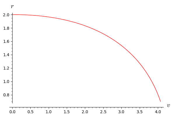

So pictorially, we have:
https://www.physicsforums.com/attac...296920/?hash=0ada85ddb1326ac3dba60e793c42457e
In a later post, I will calculate the proper time elapsed for the statite between A and B and A and C. I will also calculate the proper time for the probe between A and its receipt of signal B, and between A and its receipt of signal C.

I think I have a full solution for this. First, I'm going to take the slightly easier case where we have an object falling radially from infinity and passing a given radius ##r_0## at some time. We want to calculate the maximum time that we can wait at ##r_0## before sending a light signal that will reach the object a) before the event horizon and b) before the singularity.
I'll use ##w = \sqrt u = \sqrt{\frac{r}{2M}}##.
First, we have the solution to the radially infalling object:
$$t = t_0 + 2M\bigg [\ln\bigg | \frac{w +1}{w-1}\bigg | - \frac 2 3 w^3 - 2w \bigg ]$$Where, if we take ##t = 0## at ##r_0##, then $$t_0 = -2M\bigg [\ln\bigg | \frac{w_0 +1}{w_0-1}\bigg | - \frac 2 3 w_0^3 - 2w_0 \bigg ]$$Next, we have the solution for a radially inbound light pulse:
$$T = T_0 - 2M \big [w^2 + \ln|w^2 - 1| \big ]$$Where, if we take ##T = 0## at ##r_0##, then:
$$T_0 = 2M \big [w_0^2 + \ln|w_0^2 - 1| \big ]$$We can do what we did before and look at the difference (Note: corrected an error in this line: I had ##2w^2##):
$$t - T = t_0 - T_0 + 2M\big [2\ln(w + 1) -2w - \frac 2 3 w^3 + w^2 \big ]$$That gives us the maximum time we can wait for a light pulse to reach the object before the event horizon at ##w = 1##: (corrected same error as above)
$$(t - T)_{max} = t_0 - T_0 + 2M\big [\ln 4 - \frac 5 3 \big ]$$Now, we have:
$$t_0 - T_0 = 2M \big [\frac 2 3 w_0^3 +2w_0 - w_0^2 - 2\ln(w_0 + 1) \big ]$$And, converting to local time at ##w_0##, this gives the maximum time at that location if we want a light signal to reach the object before the event horizon:$$\Delta \tau_{max} = \sqrt{1 - \frac 1 {w_0^2}} \bigg (t_0 - T_0 + 2M\big [\ln 4 - \frac 5 3 \big ]\bigg )$$For example, if ##r_0 = 4M##, then ##w_0 = \sqrt 2## and (another correction here, from above):
$$\Delta \tau_{max} = 2M(0.474) = 4.7 \mu s$$Taking ##M## to be 1 solar mass.
As a sanity check, we can compare this with the proper time of the object between ##w_0## and ##w = 1##, which is:
$$\Delta \tau_{obj} = \frac{4M}{3}\big ( w_0^3 - 1 \big ) = 12.2 \mu s$$And, in fact, we can see that the dominant factor in the above equation for ##t_0 - T_0## is indeed ##\dfrac{4M}{3}w_0^3##, which is, as we might expect, the proper time for the object to fall from ##w_0## to the singularity.
I'll post this now. More to come ...

PAllen said:
or maybe Eddington-Finkelstein (because they are great for light paths).
I was using Eddington-Finkelstein, but I didn't immediately see how to tie it all together. The solution is:
The inbound light pulse has ##v = v_0##, which is constant. That means for the light path (using capitals for the Schwarzschild coordinates of the light pulse) we have:
$$v_0 = T + 2M\big (W^2 + \ln\big |W^2 - 1 \big| \big ) = T_0 + 2M\big (w_0^2 + \ln(w_0^2 - 1) \big )$$While for the object we have:
$$v = t + 2M \big (w^2 + \ln \big |w^2 - 1 \big | \big ) = t_0 + 2M\bigg [-\frac 2 3 w^3 -2w + \ln\bigg |\frac{w+1}{w-1}\bigg | \bigg ] + 2M \big (w^2 + \ln \big |w^2 - 1 \big | \big )$$And, when ##w = 0## we have:
$$v = t_0$$We want the object and light to coincide at ##w = 0##, ##v = v_0##, hence ##t_0 = v_0##. And, if now we set ##t = 0## at ##w_0## for the object, then we have:
$$0 = v_0 + 2M\bigg [-\frac 2 3 w_0^3 -2w_0 + \ln\bigg |\frac{w_0+1}{w_0-1}\bigg | \bigg ]$$And, finally, that gives us:
$$T_0 = v_0 - 2M\big (w_0^2 + \ln(w_0^2 - 1) \big ) = 2M\bigg [\frac 2 3 w_0^3 + 2w_0 - \ln\bigg |\frac{w_0+1}{w_0-1}\bigg | \bigg ] - 2M\big (w_0^2 + \ln(w_0^2 - 1) \big )$$And:
$$T_0 = 2M\bigg [\frac 2 3 w_0^3 + 2w_0 - w_0^2 - 2\ln (w_0+1 ) \bigg ]$$

It turned out to be fairly easy to do a numerical solution of the infall problem for an initial r=2 r_s in SageMath. I am posting an image of the unevaluated worksheet to document the process of what commands need to be input. There are a fair number of comments and some non-essential displays. However, the program output isn't shown. I can try to post an image with the output present if there is interest.
Fair warning - I haven't used the program before, and I haven't compared my results to the various others posted.
Below is the .png of the unevaluated worksheet (sorry it got so squished in the conversion processes, viewing the image standalone with a right click should allow it to be readable).
Screenshot of a SageMath worksheet titled Fall_in_EF, with code cells defining the Eddington-Finkelstein metric, Christoffel symbols and a geodesic from r = 2 r_s, with comments and no evaluated output.
And the plot output (the value of r as a function of the v coordinate - the v coordinate again represents the events at which regular ingoing light flashes from infinity are received, by the infalling test particle, the first flash being received at v=0.
Line plot of r against v, a red curve falling from r = 2.0 at v = 0.0 to about r = 0.7 near v = 4.1, with axis labels r and v.
The image of the worksheet was so bad, I decided to copy the commands with a few of the comments as that's the only way to make it legible.
In terms of the functions I derived, r as a function of v is not expressible analytically (I doubt this is possible at all). However, v as a function of r is expressible analytically:
$$v(r)=\gamma(P) (g(P)-g(r)-f(r))$$
where P = 2 R, and R is SC radius, and ##\gamma(P)## is the time dilation factor between a stationary observer at P versus at infinity.
added:
In closed form, this becomes:
$$v(r) = \sqrt {r(2R-r)} + r -2R +2R \ln \left(\sqrt {1-r/2R} + \sqrt {r/2R}\right) + 4R \arctan \sqrt {2R/r-1}$$
