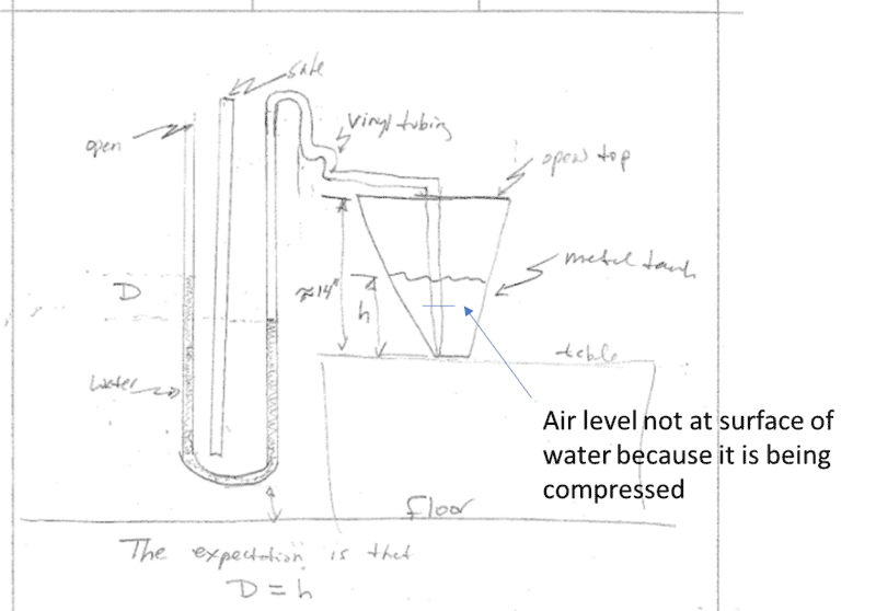

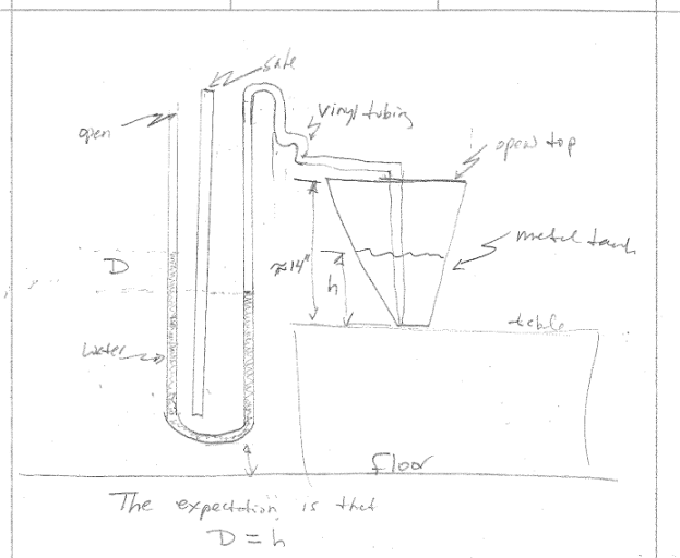

This is what I thought was a simple task, but it's causing me headaches.
I have a conical steel tank with approximately 14 liters of fluid capacity. I need to determine the volume of water in the tank when in use, and we are currently planning to measure the pressure at the bottom of the tank with a pressure sensor and relate that mathematically to the volume. (Please accept this now rather than suggest alternatives like weighing the tank, etc.)
The tank is open to the atmosphere.
I have a homemade U-tube manometer that is open on one end, and the other has tubing attached to a rigid tube that is in the tank to the bottom. As we add water to the tank, the fluid in the manometer is displaced as expected. We read the fluid displacement in one tube on a scale on the manometer and then doubled it to get the total displacement (the fluid in the other tube goes down due to the pressure exerted by the water in the tank.) However, the displacement does not equal the water level in the tank. The displacement is approximately 1/2 of the water level in the tank. It appears to be consistent for various depths of water in the tank.
What am I missing? (I'm embarrassed to ask because I have engineering degrees but haven't worked in this hands-on in years.)
Does the ID of the connecting tubes and rigid tube in the tank make a difference?
Does the fact that the tank is a cone vs. a cylinder matter? I don't think so.
Atmospheric pressure should be an issue as the tank and manometer are open to the atmosphere.

Give us a diagram, and the calculations you used.
There aren't any calculations involved in this. Here's a sketch.
An example of what I have described is that when h = 7", D is approximately 3 1/2" And the ratio between h and D seems to stay relatively constant at about 2.

As you submerge the tube the pressure at the interface between the gas and water is not is not ##\rho g h ## its ##\rho g ( h - \delta)##.
once you figure out ##\delta## ( via ideal gas law ) then you use the manometer equation $$ P_2 = P_1 + \sum_{down} \gamma h_i - \sum_{up} \gamma_i h_i $$

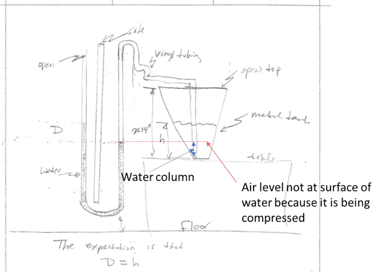

I think the force balance is different than you think.
h is only going to be equal to D if the water level in the part of the tube that is in the tank is indeed equal to the level in the tank outside of the tube. This is just a geometrical consideration.
However, if the waterlevel in the tube that is in the tank is indeed equal to the water level in the tank itself, the pressure at this waterlevel inside and outside of the tube should also be equal, i.e. 1 atm. But this can never be the case since that would mean that D has to be zero.
In other words, you need to take into account the height of the water column inside the tube that is in the tank. Now, I haven't done the analysis, but it wouldn't surprise me that this is guaranteed to be equal to D.

Seems to me like we are saying the same thing?
Well, the 'air level' (rather watersurface I would say) in the tube is indeed not going to be equal to the water surface of the tank, that much we agree on.
It has however nothing to do with compression of air, I think you can assume the air to be incompressible at these pressure levels (and otherwise you need a tube with a smaller diameter to minimize this effect)
Just to be clear, by compression I mean a difference of the volume of the air part. This air part is of coarse trapped in the tube.

I understand what you are saying now.
Yeah, I think the that ## D = h - \text{water column}##
Could be asleep at the wheel though.

I think you are saying there is a difference between the water level in the tank and the water level in the measuring tube because the air in the tube is being compressed. And the compression is being done by the water in the tank, but the air is only compressed 'so far' and then water goes up into the measuring tube.
That does make sense. And the smaller the tube, the less air in it so the less of the pressure from the tank's water is used to compress the air.
This seems to be reasonable since the manometer is measuring less than the level of the water in the tank.

I think I found the problem.
First, a geometric constraint. If the water from the tube in the tank goes up by ##H##, then the level at the entrance of the U-tube must drop by ##H## also. It follows that the level at the exit of the U-tube rises by ##H## as well. Thus, ##D## must be equal to ##2H##.
If ##D= 2H## then the level in the tube ##H## cannot be equal to the level in the tank ##h##. As the level rises in the U-tube, it pushes back on the column of water in the tube from the tank.
  • The pressure at the bottom of the U-tube of initial depth ##Y_0## is ##P_0 + \rho g \left(Y_0 + \frac{D}{2}\right)##;
  • The pressure at the entrance of the U-tube is ##P_0 + \rho g \left(Y_0 + \frac{D}{2} - \left(Y_0 - \frac{D}{2} \right)\right)## or ##P_0 + \rho g D##;
  • The pressure above the column of water in the tube in the tank is the same: ##P_0 + \rho g D##;
  • The pressure at the bottom of the tube is then ##P_0 + \rho g (D + H)## but it also must be ##P_0 + \rho g h##;
Therefore, ##h= D + H##.
But we have already established that ##D=2H##, so:
$$h= \frac{3}{2}D \ \ \ \ \ \ \ \text{or}\ \ \ \ \ \ \ H = \frac{h}{3}$$

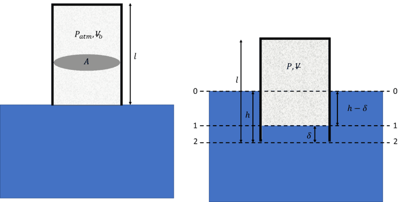

Although I find your reasoning a bit convoluted and I didn't get what ##Y_0## is, I did also find the ##h= \frac{3}{2}D## part in my own way. So I think that is correct indeed. (I think your first bullet and the first part of your second bullet are unnecessary).
So, the OP found
##D = \frac{1}{2} h## (1)
but theory states that ##D = \frac{2}{3} h##. So either the OP is a bit sloppy, or maybe the compressibility of air is a factor after all. So let's nerd this out...
To estimate this, we would need the length of the trapped air part of the tube and the tube inner diameter and a value for h for which (1) holds however.
So, a very ball park estimate: Length of trapped air: 1meter (40''), inner diameter 5mm (0.2''), if then D = 3.5'' then the gauge pressure inside the trapped air part would be 872Pa (##\rho g D## with ##\rho = 1000kg/m^3##, ## g = 9.81m/s^2## and ##D=89mm##).
We're going to apply
$$\left( \frac{p_2}{p_1} \right) = \left( \frac{V_1}{V_2} \right)^\gamma$$
With this I compute a difference in length of the trapped air part of about 6mm (0.24'').
For (1) to hold we must have a length difference of air of about 44mm (1.75'') if I'm correct. This is because:
##h = D + \delta H## (2)
if ##\delta## is taken to be some factor that takes compressibility into account (i.e. the waterlevel in the part of the tube that is in the tank wil rise a bit). Then we still have
##D = 2H## (3)
Note that this is the other side of the trapped air part, so at the 'manometer' side. This is to say that ##\delta H## change in waterlevel in the tube part will only push the waterlevel at the manometer side a distance ##H## downward (and upward at the open side...). Take (2) and (3) together:
$$ h = D + \delta \frac{D}{2} = \left( 1 + \frac{\delta}{2} \right) D$$
or
$$ D = \frac{1}{1+\frac{\delta}{2}} h$$
For ##\delta = 2## we find the relation ##D = \frac{1}{2} h## meaning (1) holds.
So, after compression of the air ##D## should still be 3.5'' (89mm) since otherwise the pressures aren't correct anymore. This means the watercolumn in the tube that is in the tank is ##H=44mm## before compression. After compression it is ##\delta H## so ##(\delta - 1) H = 44mm## is the length that the trapped air has contracted due to compression, if the relation (1) is to hold.
Since there is quite a difference between 6mm (estimated contraction of trapped air) and 44mm (needed contraction of trapped air for ##D = \frac{1}{2} h## to hold) I think compression is not important here. But I must admit that it was closer than I thought it would be...
So, that was really much more verbose than I wanted it to be... But yeah...
berkeman said:
Please explain why you are standing on your head (and wasting our time) to do this simple task in such a poorly-engineered way.
Although not stated clearly, I think one constraint is that he cannot drill a hole in his tank.
Even if there was a better solution for this problem, I find it rather challenging (in a fun way) to try to explain why this real-life result actually happens.
The height of the fluid in the U-tube at rest (when both "legs" are of equal length).
I was going step-by-step, evaluating pressure at every point from one end to the other, making sure I had it correctly.
...it's because as the water goes up the tube in the tank (toward the liquid level), the pressure goes down, not up. You have two manometers, one starting neutral and one starting pressurized, and when you connect them they meet in the middle at half height/pressure.
Now knowing that, he can use the device, if he is constrained to not add any holes in the tank.
berkeman said:
Okay, this silliness has gone on long enough, IMO. Please explain why you are standing on your head (and wasting our time) to do this simple task in such a poorly-engineered way. Is this a schoolwork assignment from a demented professor? Or a Tik-Tok challenge?
I'm inclined to agree with you when you say it's been made highly over-complicated.
The pressure inside the enclosed tube will be the same both ends (if you ignore the density of air). So the relative vertical position of the tube and the tank is irrelevant within a very small amount. The internal air pressure and any consequent density change is negligible so you can treat the two halves independently. How is the red line on the diagram of any consequence if the vertical column of air doesn't contribute to pressure?
The internal air pressure will be due to the difference in column heights
P=ΔHρg
It will also be due to the difference between tank water level height (h) and the position of the meniscus in the tube
P=(h-d)ρg
So ΔH = h-d
If you introduce air into the tube until bubbles can be heard then d is zero and H will then be equal to h. Job done? Alternatively, you could detect when the sensing tube is 'just full of air' with a float and contact system.
Needless to say, there has to be a conversion table to relate water level with actual volume if the tank is not a cylinder.
In minimum syllables:
The manometer that you built must be 'read' correctly. The pressure at the bottom of the tank is the difference in levels for the 2 legs of your 'U.' Using only 1 level is acceptably close for very low pressure measurements (like HVAC duct balancing), but will become increasingly incorrect as pressure increases. Note post 25 - the effective level may not be what you think it is.
