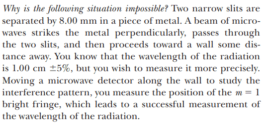

For this problem,

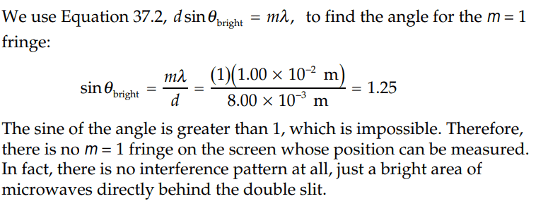

The solution is,
However, when they found the angle, they did not account for the uncertainty. I guess this is allowed still since the sine of the angle will still be greater than 1, correct?
Would accounting for the uncertainty bring the value of the sine to less than 1? What do you think?

No it would not. Is that the justification they made for not accounting for the uncertainty?

Nope. It would be the justification you provided in post #3.
A few additional thoughts…
Assume that the ±5% uncertainty determines the allowed range of ##\lambda##. Then ##\lambda## must be between 0.95 cm and 1.05 cm.
(Though note that if ‘5%’ is a standard deviation, then ##\lambda## can be outside this range.)
The smallest possible value of ##\sin \theta_{bright}## (for m=1) is determined by the smallest possible value of ##\lambda##. So, IMO, the model-answer calculation should have been done using ##\lambda## = 0.95 cm rather than ##\lambda## =1.00cm.
But really, no calculation is needed. It is not difficult to argue that the formation of any bright fringes is not physically possible if ##\lambda \gt d##.
